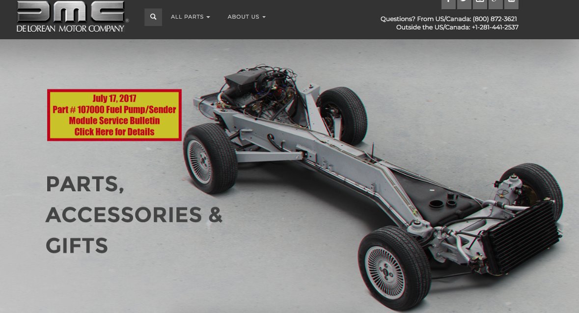

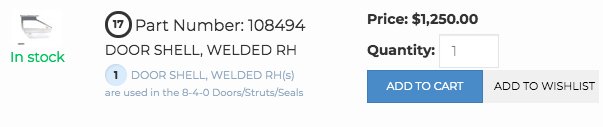

    Aw man that's neat.

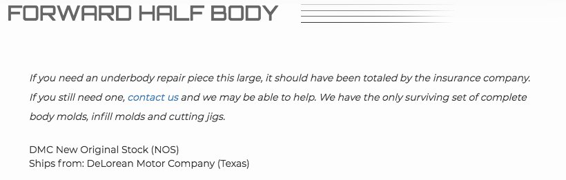

    Look, they still have TSB's!

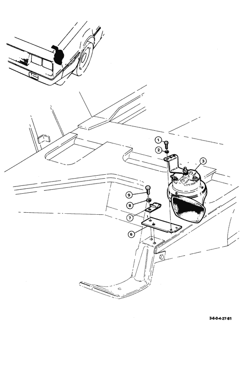

    Hmmmmmm
    NOS Horns, $18 each.

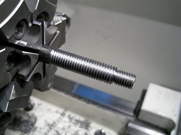

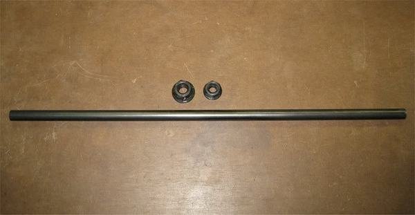

    So like a stud with metric on one end & imperial threads on the other end? If yes, not hard to make. You can buy a partially threaded stud, then use a die to thread the other end. But you'd probably have to machine down the unthreaded end to thread's major diameter before threading.
    Or I can make it if you don't need a shit ton of them. But it wouldn't be hardened if I make it. Best I could do is make it out of a stronger steel alloy or a steel alloy that you can have hardened by someone or do yourself. If strength is not important I can can easily make it out of mild steel or stainless.
    Here's the draw bar I made for my mill out of 1144 (stress proof). 7/16 thread on one end with 2 metric threads on the other end.
