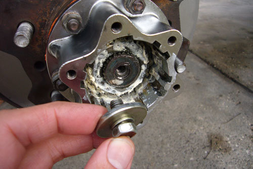

    I don't think I have that... I removed the locking hubs, popped off the snap ring and washer, and unbolted the lbj and the cvs fall right out
    anyone have a picture of this bolt?

    Here it is. I think I asked @Speedytech7 a question about this bolt when I did my swap. I believe it’s not necessary, just an added precaution to prevent the CV from sliding out of the steering knuckle.

    Yeah that bolt isn't required, just make sure you have the snap ring.
