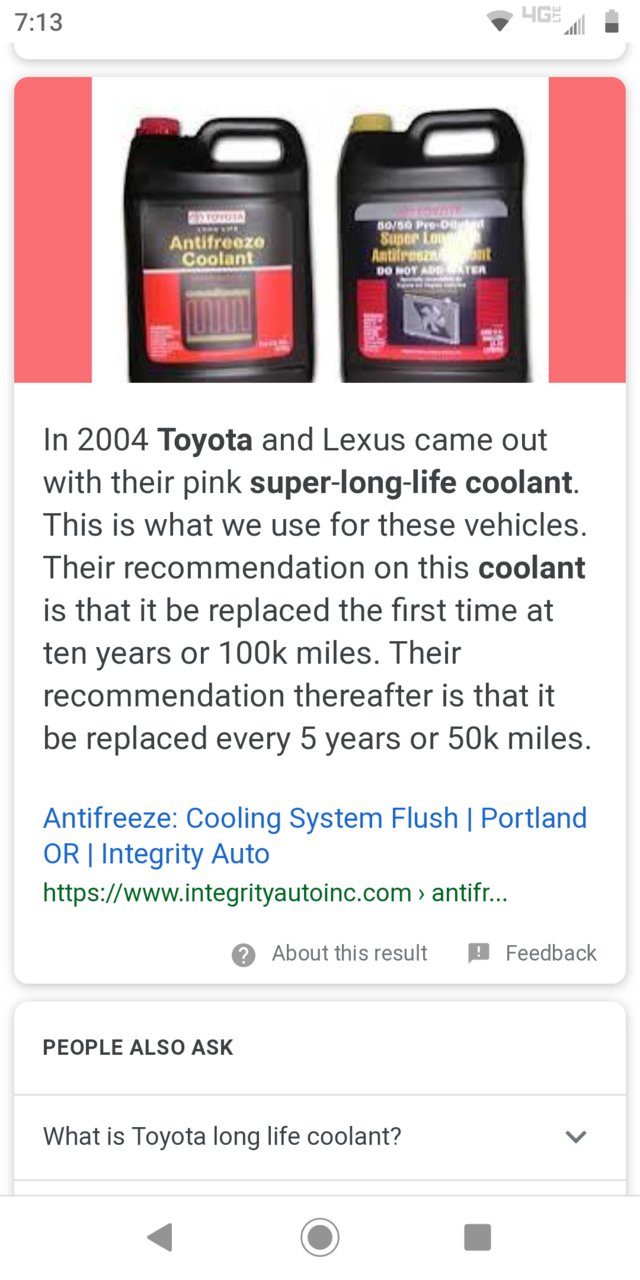

    Why? The pink is good for 5 years. Thats just pissing money away after only 2.5

    Is it 5 years? I thought it was 3. Well in that case I'll wait.
    What's the mileage for changing it? 100k I think?

  13. May 14, 2019 at 4:15 PM

    I'm right at the 50k mile interval since I last got it changed, so yeah should probably look into doing it sometime this year for peace of mind.
