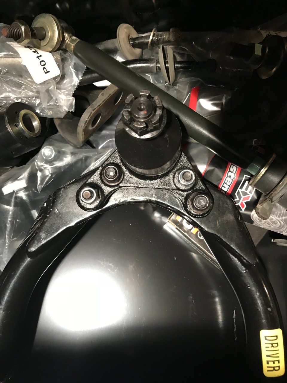

  4. Jul 30, 2018 at 10:13 PM

    Gotcha, so for the uca can you just undo the 4 bolts that secure the ubj and attach it to the aftermarket one?

  6. Jul 30, 2018 at 10:14 PM
    Sperrunner
    Sperrunner UA342
    Feb 23, 2018
    #245334
    50,665
    Miguel
    El Cerrito, Ca
    2023 Ford F250
    Its the company truck
    Thats how the uca attaches to the body 4bolts hold ubj to uca

  8. Jul 30, 2018 at 10:16 PM
    Prayn4surf
    Prayn4surf 20 minutes late
    Jan 6, 2017
    #206776
    6,016
    Socal
    2004 Tacoma xtra cab
    I understand how it connects to the frame, how bout the spindle
  9. Jul 30, 2018 at 10:16 PM
    Sperrunner
    Sperrunner UA342
    Feb 23, 2018
    #245334
    50,665
    Miguel
    El Cerrito, Ca
    2023 Ford F250
    4bolts hold the uca to the ubj. So you can leave the ubj attached to the spindle

  11. Jul 30, 2018 at 10:17 PM
    Prayn4surf
    Jan 6, 2017
    #206776
    6,016
    Socal
    Thats what I was asking. I saw those little bolts, well that actuallt makes it super convenient for a uca swap. That shouldnt take too long
  12. Jul 30, 2018 at 10:19 PM
    Sperrunner
    Sperrunner UA342
    Feb 23, 2018
    #245334
    50,665
    Miguel
    El Cerrito, Ca
    2023 Ford F250
    The uca is easy. The coil is whats hard
  13. Jul 30, 2018 at 10:19 PM
    Prayn4surf
    Jan 6, 2017
    #206776
    6,016
    Socal
    I got pretty good at tearing apart front end suspensions on first and second gens and I am sure we could have that done in a couple hours working on either side.
    Edit didnt see the coil isnt a coil over

  15. Jul 30, 2018 at 10:21 PM
    Prayn4surf
    Jan 6, 2017
    #206776
    6,016
    Socal
    Makes sense, so we need a sktchy spring compressor

  17. Jul 30, 2018 at 10:21 PM
    Sperrunner
    Sperrunner UA342
    Feb 23, 2018
    #245334
    50,665
    Miguel
    El Cerrito, Ca
    2023 Ford F250
    You have to compress the fuck out the coil then man hadle the fuck out it to take it out, and teh new coils are even taller then the stock ones so that will be more of a bitch to get in. One of the reasons I haven’t installed it yet

  20. Jul 30, 2018 at 10:22 PM
    Sperrunner
    Sperrunner UA342
    Feb 23, 2018
    #245334
    50,665
    Miguel
    El Cerrito, Ca
    2023 Ford F250
    I have the compressor
