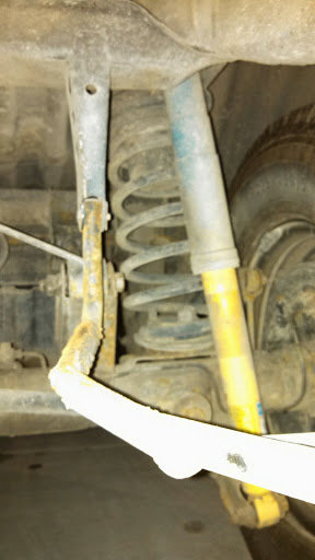

    On another note i saw some van dude say he gets 12” of travel on the stock link setup in his van. Using ford areostar springs and some long shocks

    It's less Tacoma and more mod
    How do the shocks mount, I have tons of spare shocks I'm doing nothing with
    Rather get em off to someone who can use em

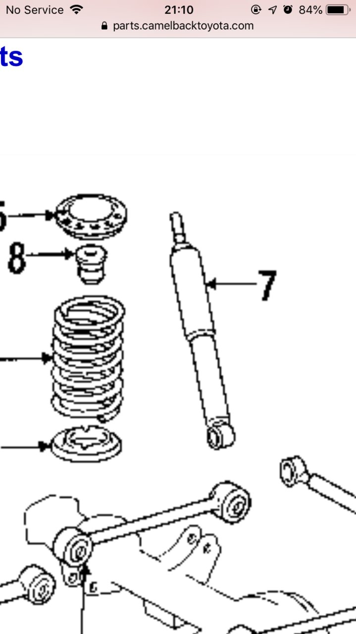

    Look like second gen rear shocks, those are cheap. Pin mount top and ring mount bottom

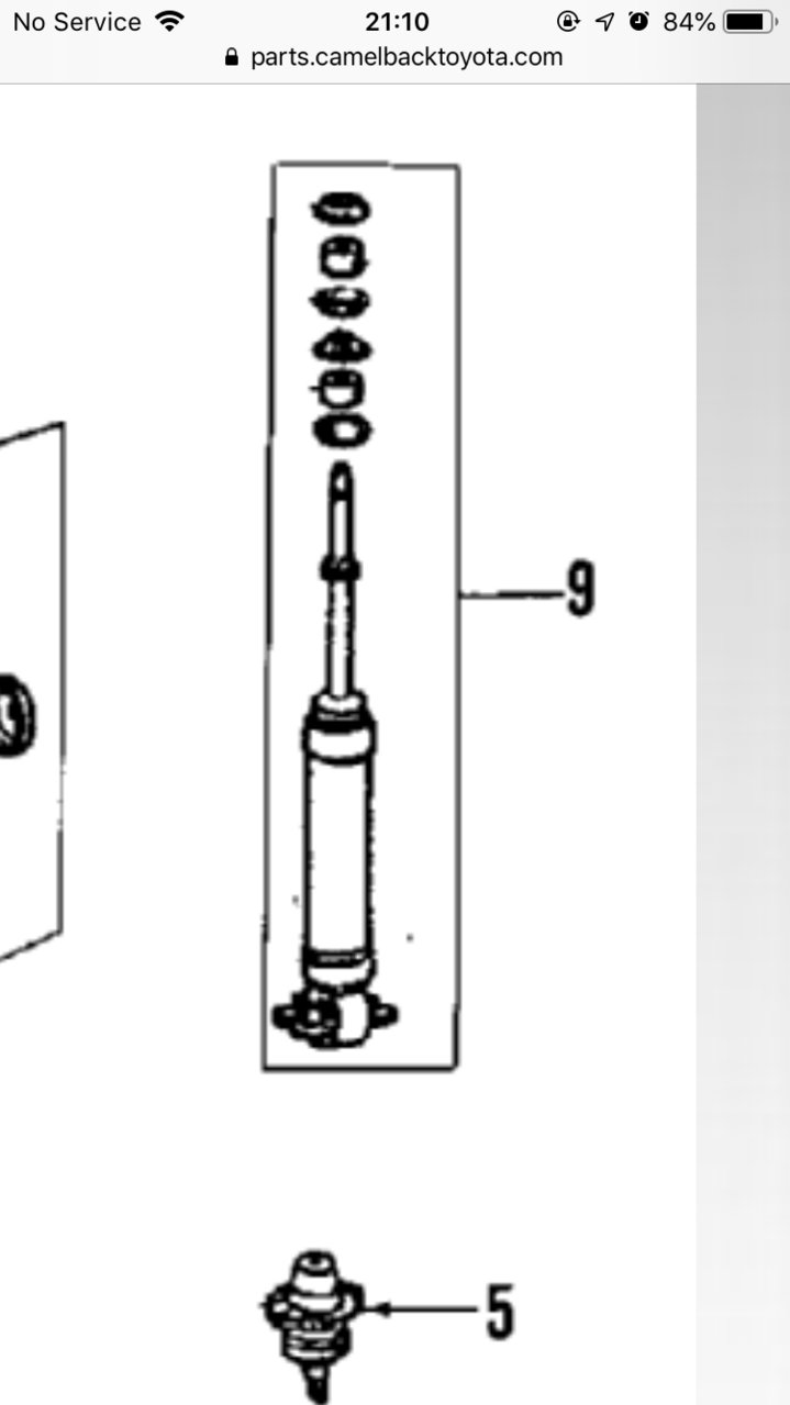

    Yeah thats what I thinking. Probably pick some 2nd gen stuff for test fitting then get QA1 stuff after I figure out the size. Or go crazy with some fox shocks lol.
    Can't do coilovers with pin mounts. You would have to make a new mount system

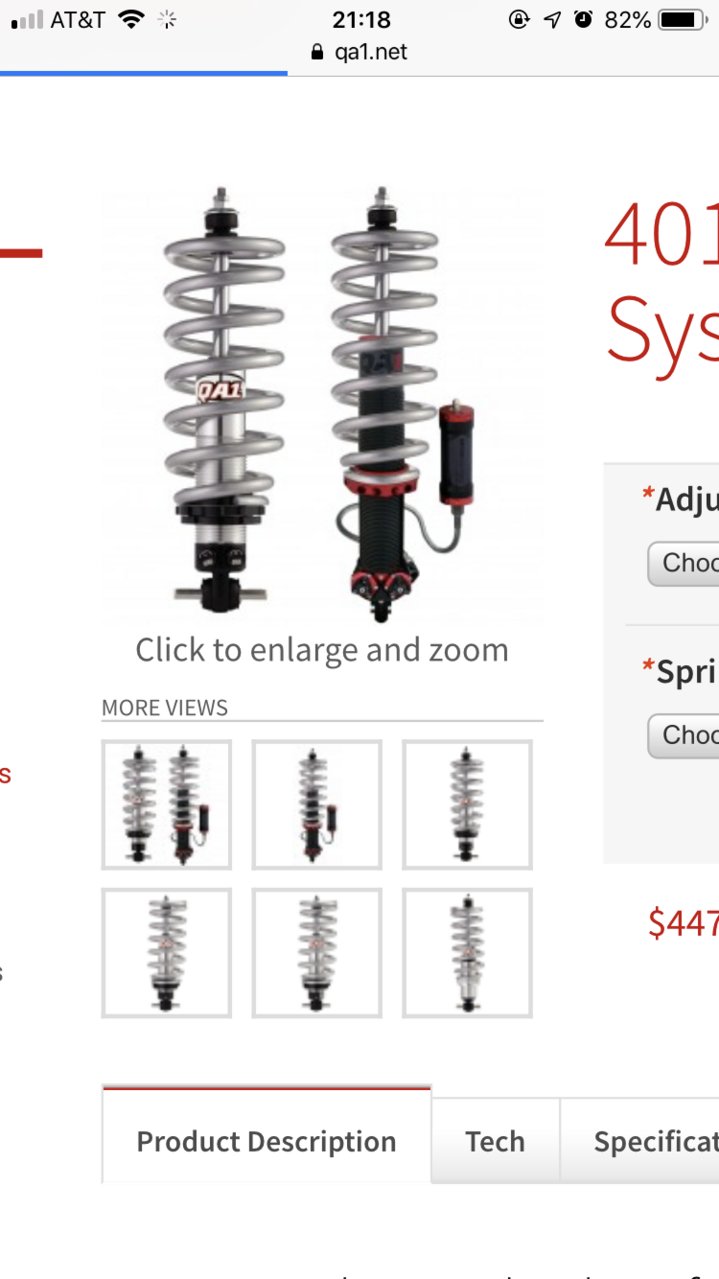

    Its the company truck
    But i mean qa1 has this
    That's for something with an upper coil bucket already molded in
    Qa1 makes dual adjustable shocks that you can tune.

  20. May 28, 2019 at 9:22 PM
    Speedytech7
    Feb 20, 2014
    #123587
    57,544
    FCQM+VG Cheney, Washington
    Look for land cruiser 80 rear shocks, they're the same style as yours. What's the front like, king will make anything
