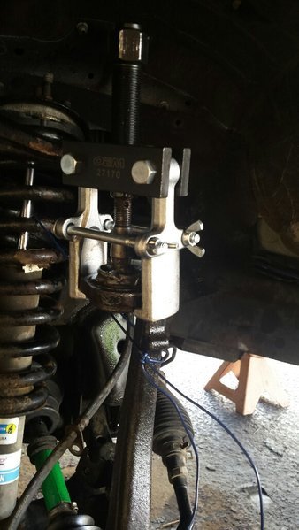

  3. May 28, 2019 at 9:48 PM

  4. May 28, 2019 at 9:50 PM
    JKO1998
    JKO1998 Well-Known Member
    Jun 2, 2015
    #156578
    53,145
    Utah
    Did you get the snap ring?
  5. May 28, 2019 at 9:51 PM
    Sperrunner
    Sperrunner UA342
    Feb 23, 2018
    #245334
    51,033
    Miguel
    El Cerrito, Ca
    2023 Ford F250
    Its the company truck
    You need the press and make sure you take the snap ring off

  7. May 28, 2019 at 9:52 PM
    Wulf
    Jan 30, 2015
    #147523
    62,504
    rock raisin
    The ball joint press from the parts house is too small and getting it to press straight with a 3 jaw puller is a bitch lol
  8. May 28, 2019 at 9:52 PM
    JKO1998
    Jun 2, 2015
    #156578
    53,145
    Utah
    Lemme go find what I used, worked great

  11. May 28, 2019 at 9:56 PM
    JKO1998
    Jun 2, 2015
    #156578
    53,145
    Utah
    Pittman arm puller

  13. May 28, 2019 at 9:58 PM
    Wulf
    Jan 30, 2015
    #147523
    62,504
    rock raisin
    Coincidentally I have one supposed to be delivered tomorrow

  15. May 28, 2019 at 9:59 PM
    JKO1998
    Jun 2, 2015
    #156578
    53,145
    Utah
    Autozone bro

  16. May 28, 2019 at 9:59 PM
    Wulf
    Jan 30, 2015
    #147523
    62,504
    rock raisin
  17. May 28, 2019 at 9:59 PM
    Sperrunner
    Sperrunner UA342
    Feb 23, 2018
    #245334
    51,033
    Miguel
    El Cerrito, Ca
    2023 Ford F250
    Yeah not gunna happen. You need that ball joint press. Just get one on Amazon. The amount of time you spent complaining it would of arrived already

  19. May 28, 2019 at 10:00 PM
    Sperrunner
    Sperrunner UA342
    Feb 23, 2018
    #245334
    51,033
    Miguel
    El Cerrito, Ca
    2023 Ford F250
    Say fuck the deposit and cut the cup you press in to shorter so it fits
    Running Board Man likes this.
  20. May 28, 2019 at 10:01 PM
    Wulf
    Jan 30, 2015
    #147523
    62,504
    rock raisin
    Nah, the way it works now is you pay the full price and then get a refund if you bring everything back in good shape. There is no deposit
