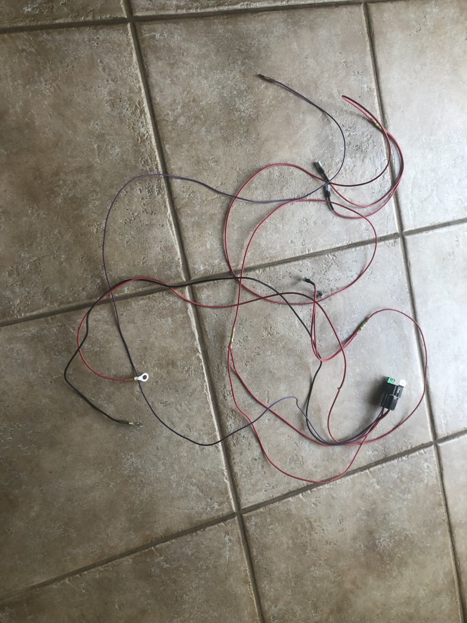

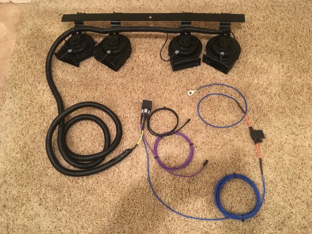

    So Im gonna get rid of, or bypass the stock horn relay? Basically, what Im confused on is how to hook it up to the stock horn/steering wheel switch.

    Stock wiring is all there unmodified. But you need to create an independent relay harness that adapts to it. The coil wire would connect to the stock horn wire, positive and negative to their respective places on the battery, and momentary relay power to the four horns.

    Ok, so in this pic: File_005.jpg
    The black or purple (whichever one is the switching wire) gets spliced into the stock 12v wire going into the horns, correct? So effectively, there are 2 relays for the new horns?
    What size relay you running?

    That’s a really really old pic, I think that’s one of the first systems I ever sold.
    Yes. Two relays. The stock relay could handle it fine, however the stock wiring could not. Stock wiring is roughly 22GA and the Delco-Remy wire is roughly 14GA.
    You just need the signal from the stock horn harness to activate your independent relay. I run 30/40 Amp SPDT relays.

    Ok I gotcha. These horns ground to the brackets right?

    @Blue92
    I have a customer returned harness if you don’t want to make one yourself. It’s a much earlier revision, but I can add in the Metri-Pack fuse holder at the battery connection. I discontinued the relay fuse holder.
