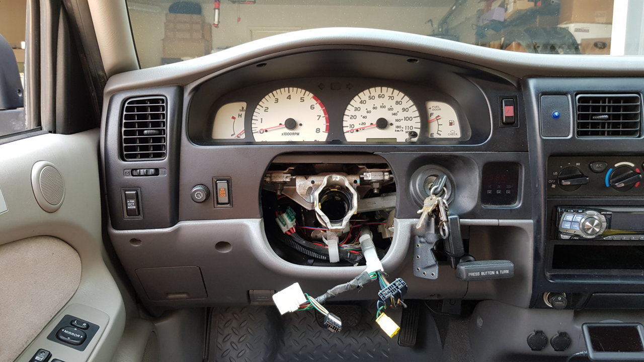

    Yep, the radio bezel doesn't need to be completely removed. Only the right side of the cluster bezel tucks under it, on an 01-04 anyway.
    Heck it only took 10-15 mins to remove my entire steering column the very first time.

    Remove the lower dash cover, few 10mm bolts and a few screws. Remove the cover for your HVAC panel and the ashtray. Remove the hidden screws. Pull the central trim out, but don’t remove it.
    Remove the three or four screws from the surround of the instrument cluster. Make sure your tilt steering column is all the way down.
    Remove the screws and or bolts hidden under the lower dash cover.
    Pull the cluster surround off, remove the four or so screws holding the cluster and the three harness connectors. Done.

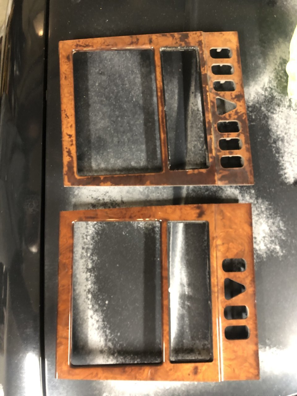

    Just got the new radio trim in the mail last night so I can finally install the double DIN stereo.
    Had to buy it for $170 just because the one I found didn’t have power seat switch blanks.

    So cool, I love that originally those were all made with real burlwood. Well Benz is a luxury brand so I guess it would. Do the BMWs use real wood as well?

    On 01 up he may have to pull the 12v accessory panel. Radio bezel won't come out unless that panel comes out straight. It's only 2 push rivets that needs to be removed but it's held in with clips also. If he's never pulled it off, it can be a bitch sometimes. The 12V plugs a have short wires so if you got big hands it can be hard to put them back on but shouldn't need to unplug them.
    Radio bezel has to come off straight because of the ac vents. Don't have to completely remove it but all the screwes will have to come out. Only 3, one behind the ash tray ktowards the back, up above doesn't need to come out), 2 behind the climate control bezel.
    Pay attention when you pull off the knobs. Don't loose the D shaped spring clips, Toyota doesn't sell them seperately, have to buy tge whole knob. Knobs for 01-04 cost more than 00 down. The clips should stay in the knob when you pulk them but some times they get stuck on the climate control. Have to put the clips back into the knobs to put the knobs back on.
