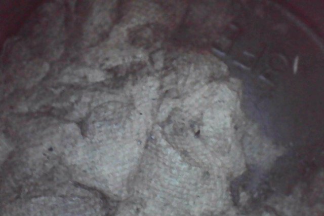

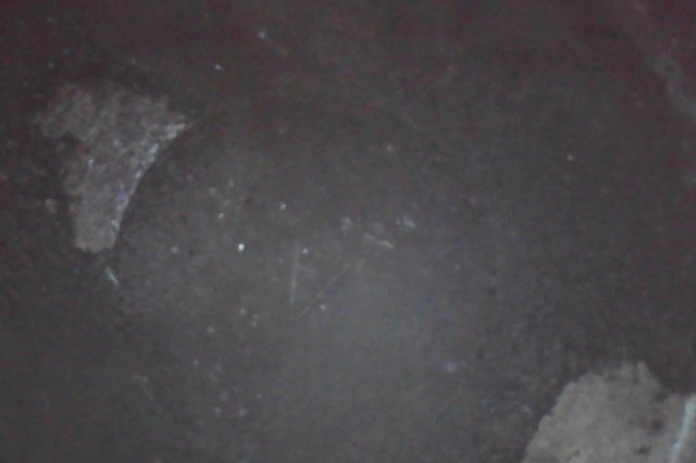

    It's horrifying.
    Cylinder 2, perfectly fine.
    Cylinder 3: Electric Boogaloo

    Damn, time to pull the head

    That looks like quite a bit in cyl 3. But then again how much could have gotten in just through a valve. That don't look like it'll be easy to get out the spark plug hole. I suppose he could try to blow it out the intake or exhaust valves, if the super charger is off or unbolt the exhaust.

    Metal finger picker tool will fit in the spark plug hole.
    Towel will fit

    He can pull that out no prob with the little grabber tool, worst case he can wet it down with a touch of fuel to make it soggy and compliant

    It's about half of a half sheet paper towel. It's so soaked in fuel it crumbles apart. I'm going to try one of those grabber tools, otherwise break it up some more and attempt to vacuum it.
