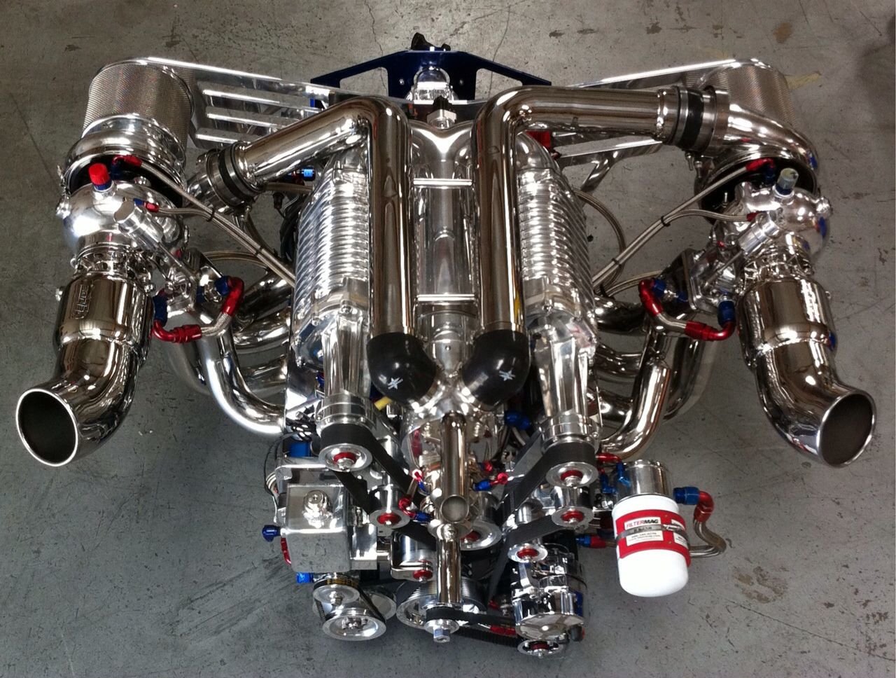

    It's less Tacoma and more mod
    It's a bit less of a restriction when there's two of them and they're M112 or twin screw

    the size of the hole in the m62 blower would likely be good for 500-600. have to remember the blower will still be letting air through too

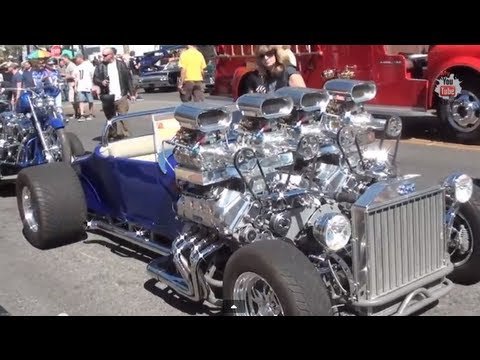

    Idek how that works. How do they transfer the power from each engine into one transmission?

    gears... its not hard. the engines have to be synced though. one making more power than the other or a major rpm difference would be bad

    I don't think I'd bother unless I was staying near 400hp. Any more than that and it's just going to be a heat pump. That bypass is going to be too small and the rotors will pass some but anything that passes through them even if there isn't compression happening is still going to be subject to latent heat transfer. Plus you have to rig a system to switch the bypass open at the right time and tune for the instant difference in pressure and flow at the crossover which is going to be a dynamic problem with each gear. An M90 would be big enough for 550 or so. But again why bother when compound turbos are easier to configure and package.

    I'm happy to talk about it, it's a cool idea, but entirely impractical. It would cost more and do less and likely do it all not that well. If you're gonna twin charge it's better to just spin the blower slower and blow through it and be happy making the 380-420hp it's going to be worth. Anything above that will be deminshing returns and bring your knock threshold even closer. There was a car that actually did everything you're talking about from the factory, it was the Nissan March Super Turbo. It worked and it helped spool it's rather large turbo and then let the turbo take over at about 3k RPM. But the SC wasn't an intake integral part so they could actually put a robust 2.2" intake switching valve in that way the turbo didn't have to bother going through the SC at all. To date it's been the only factory twin charged vehicle, cause turbos are much more efficient nowadays and the SC isn't worth it.
