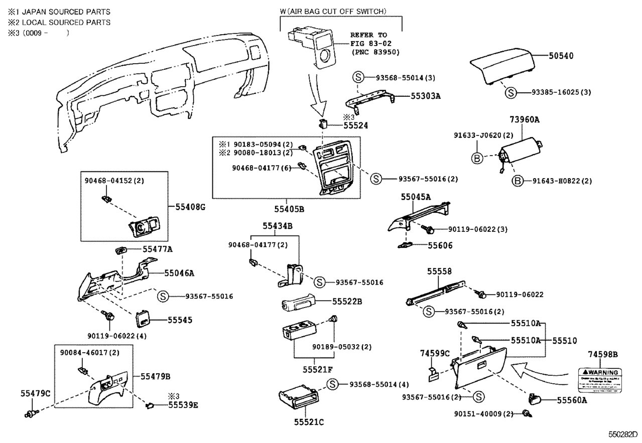

    If I'm not mistaken that is for the front console --
    Can't locate a part #. Maybe check in with Camelback & @gunny1005

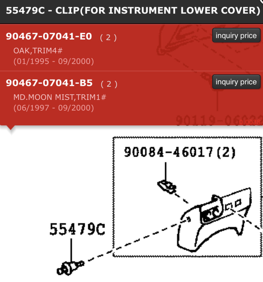

    From the website you’re scared of: (55479C)
    @vonellis the part number(s) are:
    90467-07041-E0( 2 )
    OAK,TRIM4#
    (01/1995 - 09/2000)
    90467-07041-B5( 2 )
    MD.MOON MIST,TRIM1#
    (06/1997 - 09/2000)
    Toyota uses a similar clip in a lot of places. It could also be the push clip that goes on the door panel on 1995-2000 trucks adjacent to the mirror.
