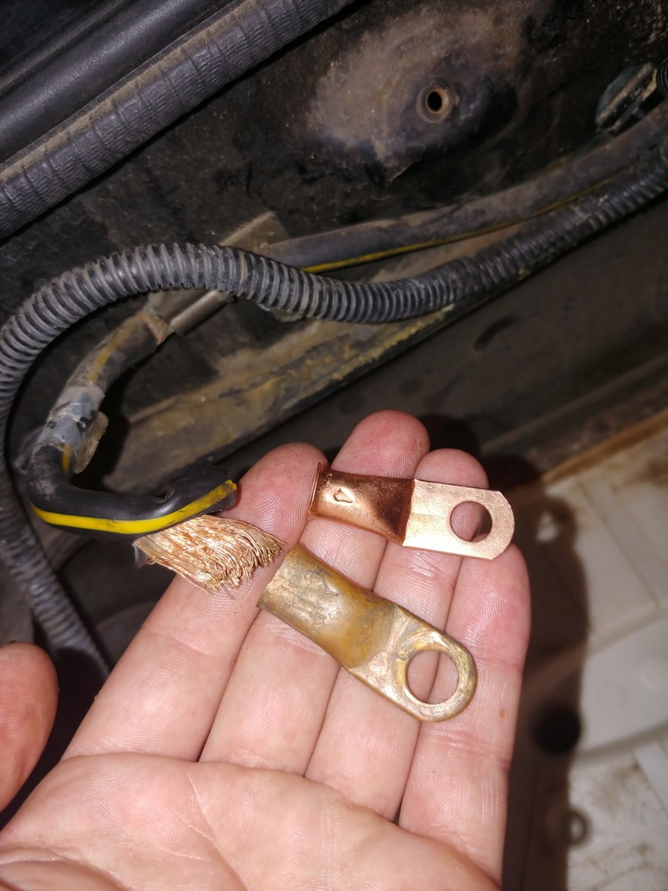

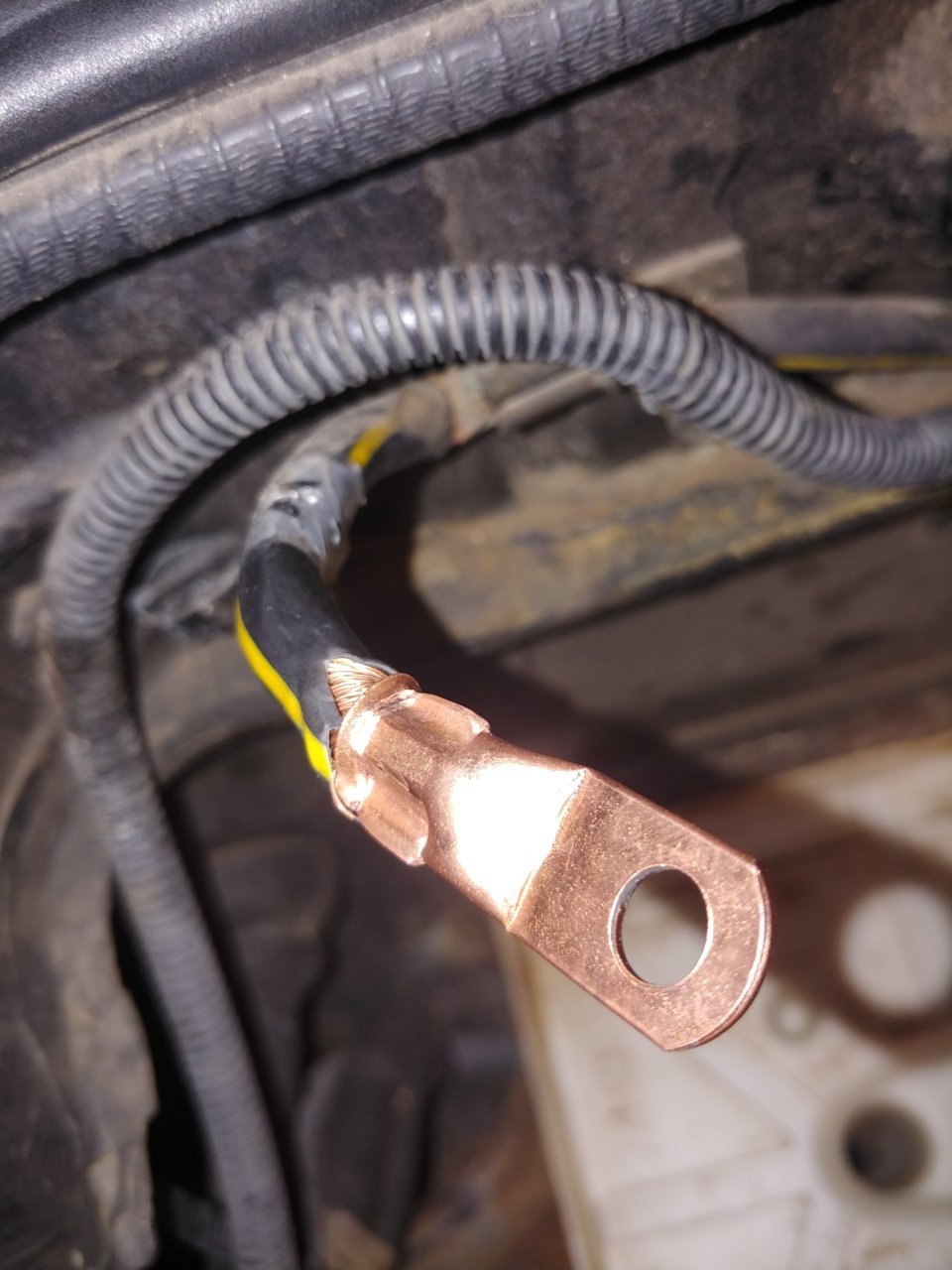

    It's less Tacoma and more mod
    I don't know why auto parts stores even sell crimp lugs cause the average moron that walks in there to buy one just does shit like this that comes apart in your hand when you try to move the wire around haha
    But I got her all fixed up fresh with the hydro crimper

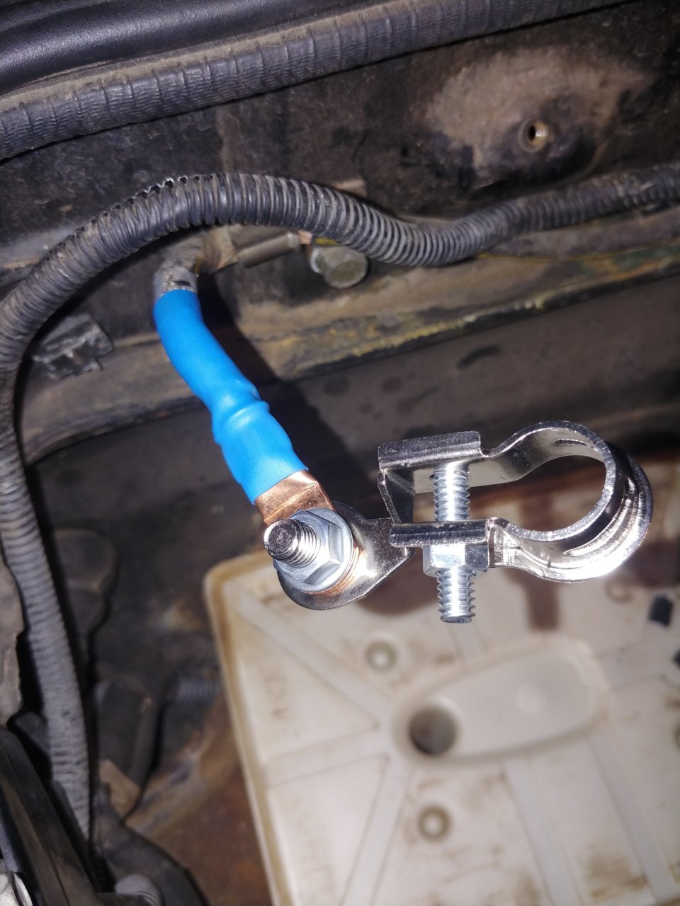

    Mil style clamps overrated?
  4. Jun 10, 2019 at 8:45 PM
    Speedytech7
    Feb 20, 2014
    #123587
    58,368
    FCQM+VG Cheney, Washington
    Just didn't have any on my shelf. I had this stuff left over from another project. Mil clamps are nice, I like them for the trucks, I don't hook up much to the car though so this little ring should be bueno

    Just the hazard fraught one. The dies could be better sized to avoid the batwings but they still crush that shit so well it'll never come off. Had it for 4 years now and I haven't even blown a seal

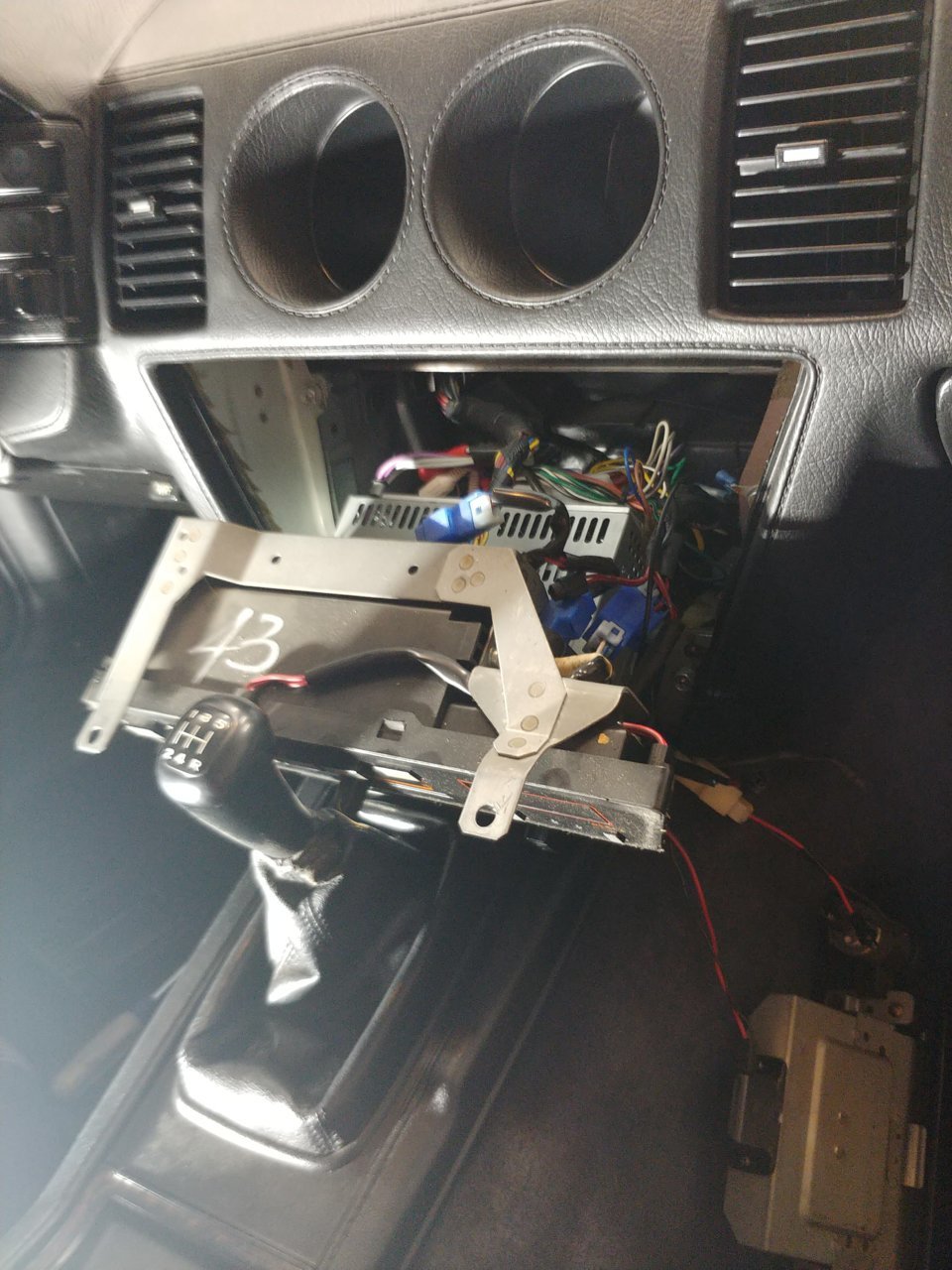

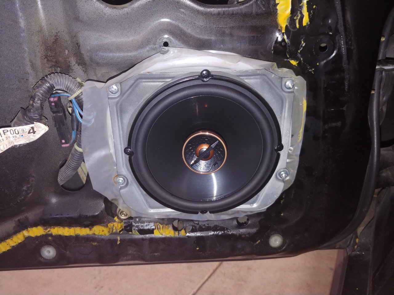

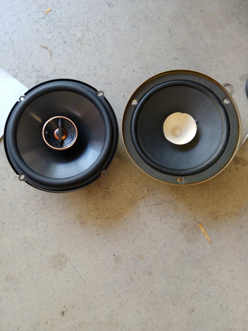

    Figured out why the Z doors rattled haha. Every clip was in wrong or broken. Got that fixed up proper now and put in some speakers and I'm working on the stereo now.
    Old and new
    Stereo puked out the dash
