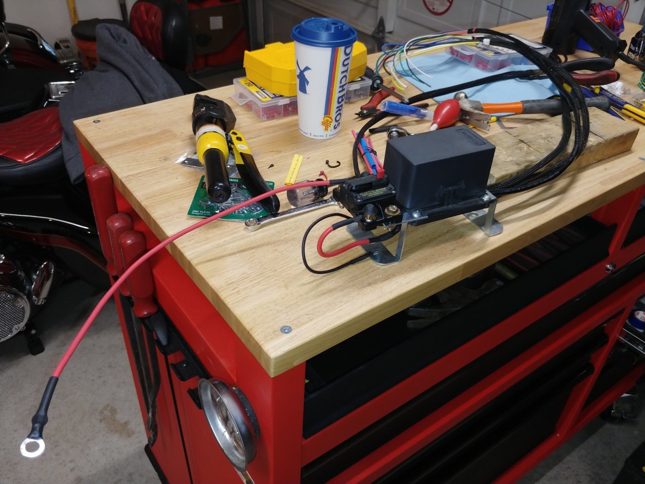

    @BTB
    Just gets urself one of these bad boys

    Is that diy?
    What / how many accessories are you adding?

    Combination relay/fuse box. Make it easy to connect a bunch of accessories and wire switches all at once without a bunch of clutter

    How do you like that crimper? Right now I'm using some vice dies but they are kinda awkward to use and not precise.

    Bought a mostly assembled box and did the main power and relay ground myself as well as the box mount and breaker mount.

    It's very good for what it is. My main piece of advice for using it, is always start with dies two sizes larger than what is needed to get the cleanest crimp. You can send it the first time with the correct size too but it doesn't look as pretty.

    I'm planning on a similar setup - probably have 4-6 light switches and compressor / locker.

    I made this one up to fit my Taco and then never installed it haha. So I guess I'll alter it again for the LC, gotta find a good spot.

    What mostly assembled box did you buy?
