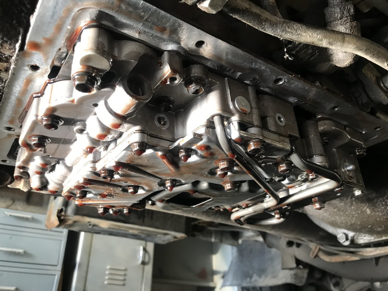

    I added a photo

    Ohhh yeah maybe don't spray degreaser on there lol

    It's less Tacoma and more mod
    It looks clean, what's up?

    You need to drain and fill. Or do nothing.

    You don't need to clean all that off. Just clean the sealing surface for the pan.

    Yeah I see, why do you wanna spray the valve body down?

    And he can hose the pan out with degreaser or brake clean and dry it off before reassembling

    It has some black gunk on it. Im just gunna wipe it down with shop towels

    Don't leave fibers

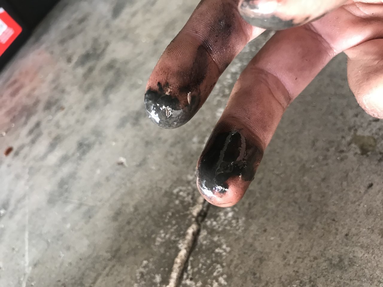

    I'm assuming that's from the bottom of the pan? Just clean the pan, magnets, and the gasket surfaces & put it back on. Nothing much else you can do or that is needed.

    Someone put magnets in the pan which are coated in that black stuff you saw on my fingers in a post above.

    They come that way to pick the clutch and bearing shit out of the fluid. Just take em out, clean them and the pan and put em back

    The magnets are supposed to be in there. Clean the pan out, wipe off the build up on the magnets. If you can't get it all off the magnet & feel you want it cleaner. Use compressed air & a rag for shielding to blow all the crap off the magnet. But like with an air compressor if you have, canned air is not strong enough.
