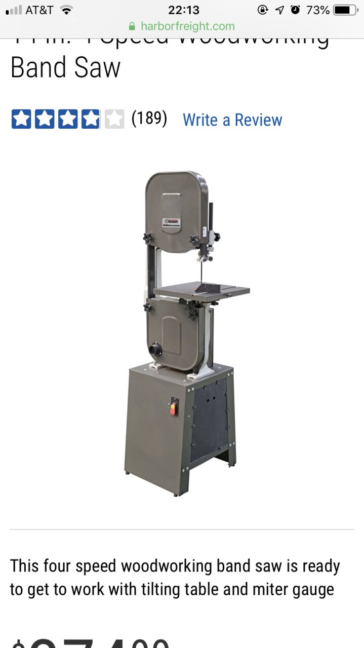

    Ah I see, vertical bandsaws like that are usualy for wood. The spindle speed is too fast for metal & is why you might be having trouble cutting metals. Can tell if it's a metal vertical bandsaws cause they are usually much beefier.
    But that horizontal bandsaw can be used in the vertical position too. Just need to make a table for it if it doesn't come with it. The ones that come with it are just flimsy sheet metal anyway.

    It does fine with metal as long as its a quick cut. Anything getting long its hard to get a strait cut going

    Could be the blade is worn and/or wrong tooth count for what you are cutting. Worn blade tends to wander on the cut no matter what you do. Or check blade tension, too loose can cause that too if the blade is good.

    Im fairly certain its the blade. Idk how old these ones are.
    The wood blade is good. Just the metal blades
