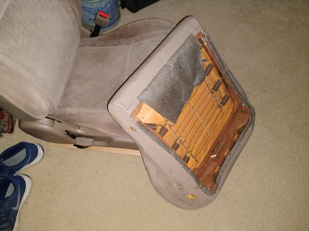

    Im not messing with the seatbacks. Just the bottoms. 4 easy 12mm bolts.

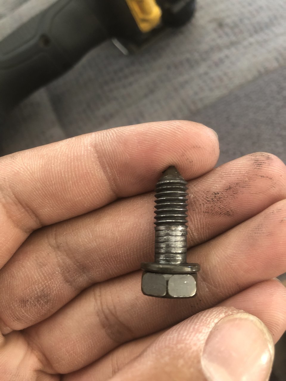

    @Blue92 The bolts on all four bucket seats between my PreRunner and 5-Lug looked like this. That’s what causes the slop in a bucket seatback.
    Vibrations over time made the bolt come loose and strip them.

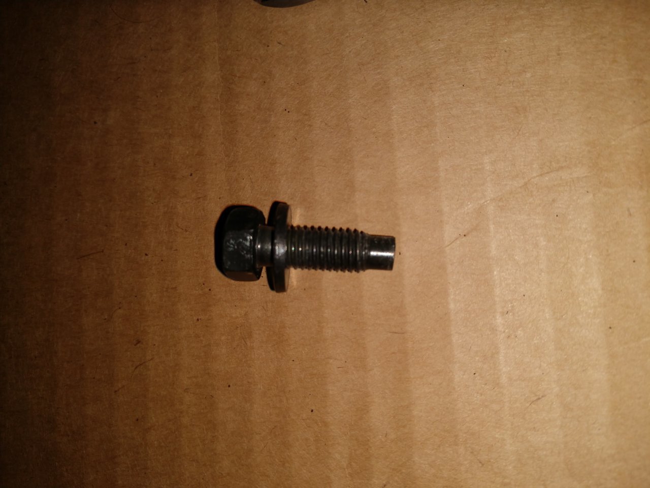

    Weird, all mine look factory new.
  18. Jun 22, 2019 at 6:58 PM
    BartMaster1234
    Aug 21, 2016
    #195197
    45,868
    Tyler
    Pittsburgh, Pennsylvania
    Flux Capacitor
    Maybe something changed in 2001. Always good a idea to put threadlocker on them.
