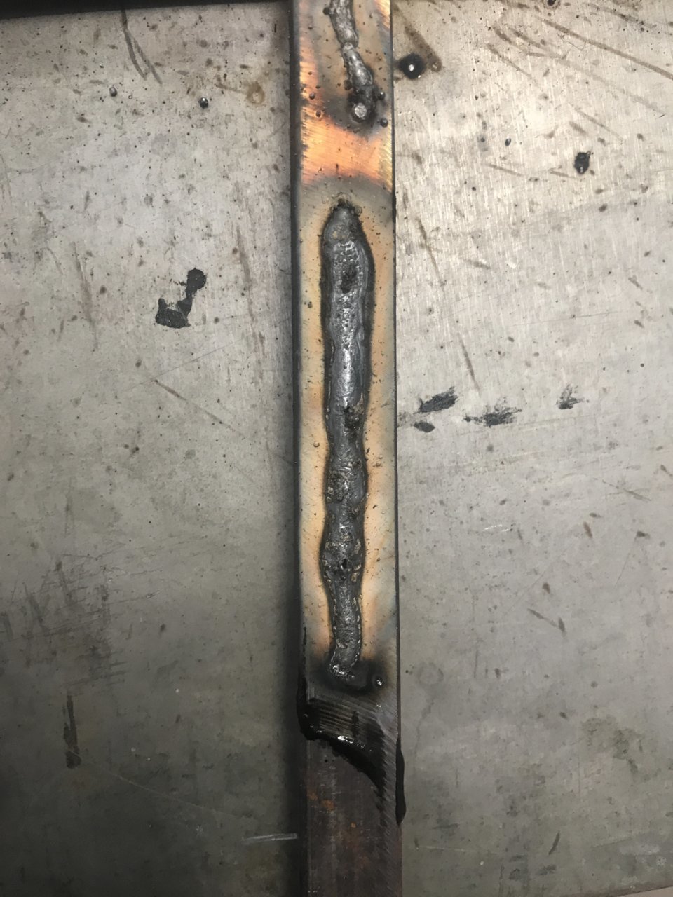

    Its the company truck
    What am i doing wrong

    Whats your technique? Flat drag? C's? Circles?

    Idk, but just by trying to picture what those are I would say flat drag

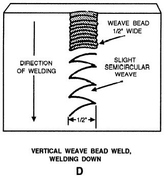

    Looks like a drag. This is my goto motion for most of my mig welding. Pic says vertical down, but I use it on everything. C'svertical-weave-bead-down.jpg
    If I need to weld something thick, and carry a wide bead Ill do the cursive e/circle thing.

    Its just flux core rn. I cant run gas till the new hose comes

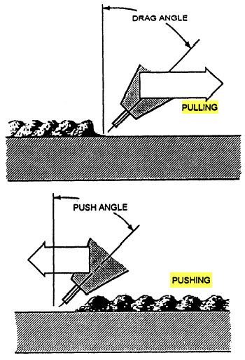

    Im seeing little holes which means youre likely pulling the puddle. With flux core you have to push the puddle. If you pull you get slag entrapment which equals little holes. c5830cb68a1b2f5079f1d7b9aa4771b8.jpg
    Edit. I had that backwards. Always pull with flux core/stick. Brain fart. Slag gotta drag.

    See my edit. I havent used anything with slag in a loooonnnggg time.

    This wave thing is a weird motion to try and do. Guess i gotta get use to it

    Stupid as it sounds I've had the best luck watching the bubble in the back of the puddle and using that to adjust my speed or pattern. It depends on the material and thickness too.
    If I'm welding something thinner to something thicker I'm doing a kind of z where I drag the puddle from the thicker side to the thinner one etc

    You may be having trouble seeing the puddle judging by the S shaped weld. What hood are you using? And what number is the darkness of the lens? I use an 11, on the darker side but it works for me. My coworker uses a 9. I about went blind when I used his hood once. Most people use a 10.
