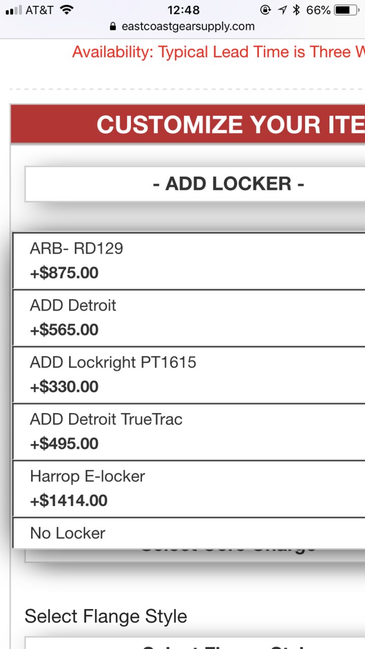

    @Prayn4surf these are my locker options. Im thinking detoit true trac unless you think otherwise

    why do you want the detroit?

    Arb all the way, detroits are a good option for the money concious for a front diff, seeming as how you dont have one, id go full locker. Detroits still are designed to slip.
    I think you can find competitive procing through ecsg

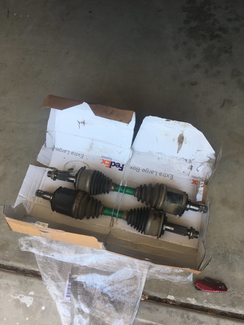

    Got my spare cv’s today! Along with brought my cat back from vet hospitol, been a gnarly last two days w a 3 year old cat3AD4F09B-66CB-402B-9C31-D0894008DD1C.jpg

    So you think a selectable locker will be better for me the a lsd?

    Probably best to ask ECGS what they would recommend

    Whats the difference between Detroit and Detroit truetrac

    the trutrac acts like a limited-slip if you have a lifted tire

    So the normal Detroit is more like a full time locker vs the truetrac is a lsd?

    Also Detroits lock when youre on the gas and unlock when you coast. Truetracs are always biasing the load to the one with least traction, it works very well but it's not a locker.

    Then listen to then man haha call the peeps that specialize in gears. Lol

    Hmm okey, well i emailed ecgs and gunna see what they say. Leaning to a arb rn
