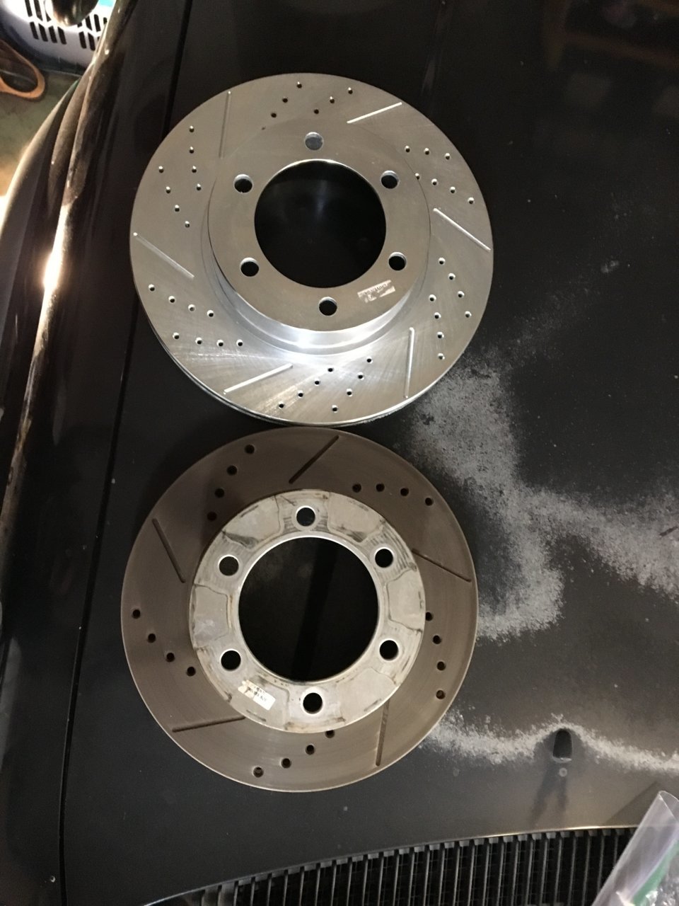

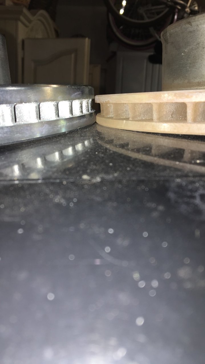

    There’s a pretty substantial difference from the stock Tacoma rotor. Those are Baer Sport Rotors, now discontinued.
    These super old pics.

    Id almost want to drive someone elses truck with these before I was to do the swap. A good set of ceramic pads and a full flush and bleed did my truck wonders. Stops on a dime, super firm pedal that doesnt take much travel at all to bring the truck to a stop.

    That’s what I had before. I had really good pads, slotted rotors, and fresh fluid for a few thousand miles.
    The difference is very subtle but you notice it when you’re towing or hauling or even braking hard.

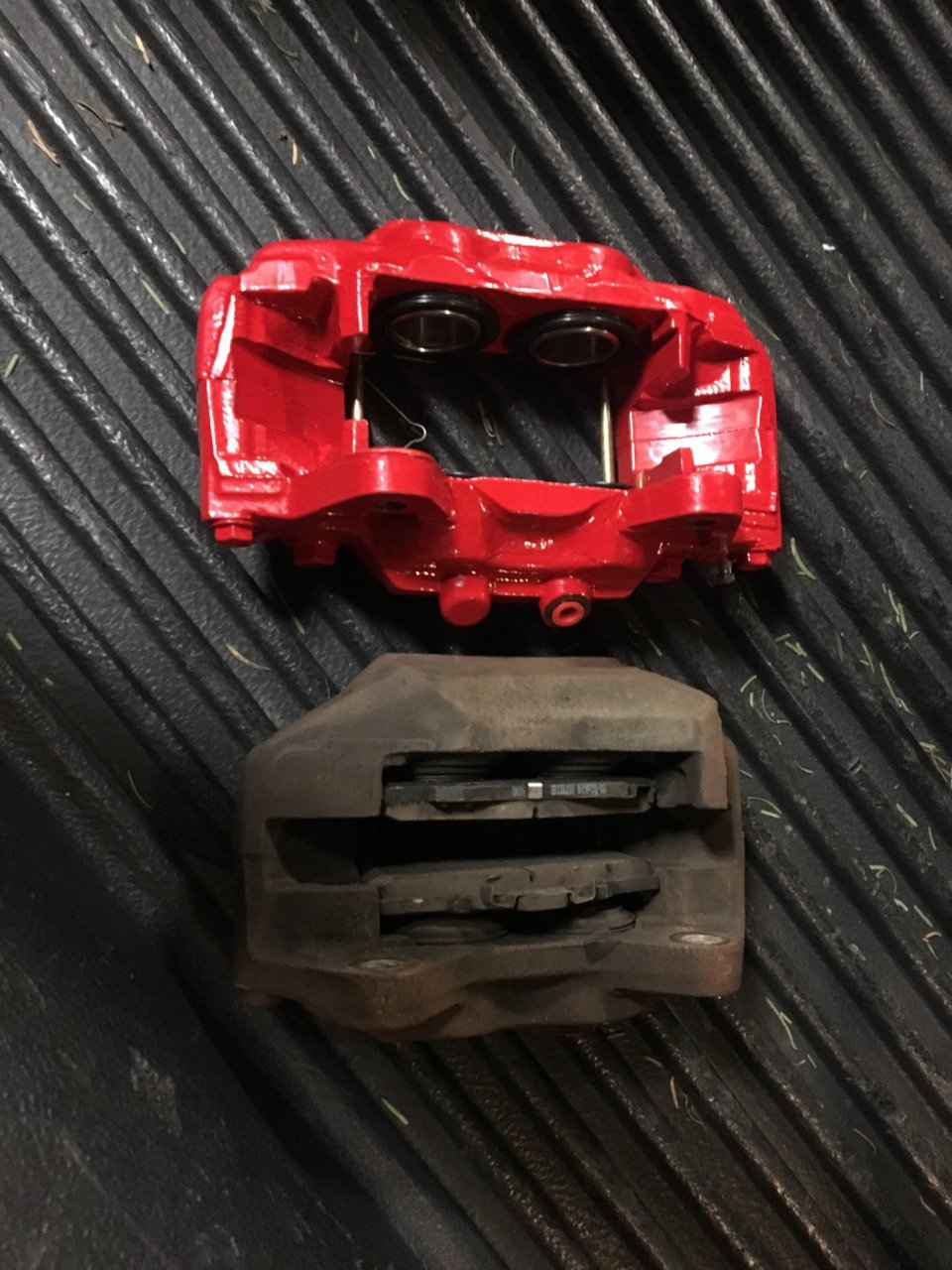

    One of the very first conversations you had with me was asking to buy by junkyard Tundra calipers haha

    I have bigger tires, extra weight from armor, it only makes sense to use bigger brakes
