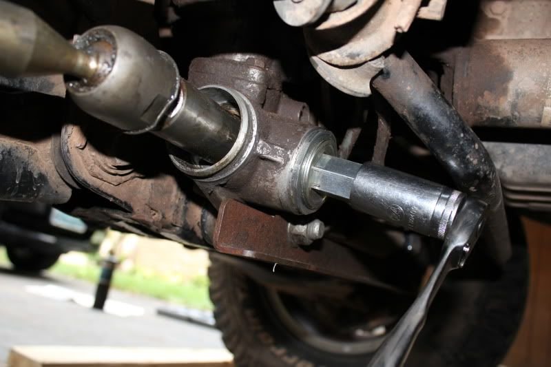

    Check your steering rack guide nut when your under the truck. Tightening them up a bit can help as well. If you go to far you'll know because your steering won't return to center. There's also the steering column rag joint that can allow slop in the system.

    This one?

    That one. lol
