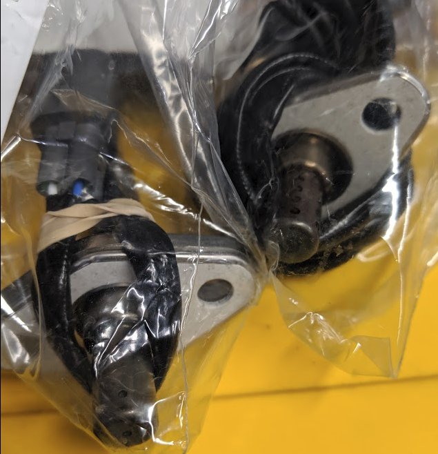

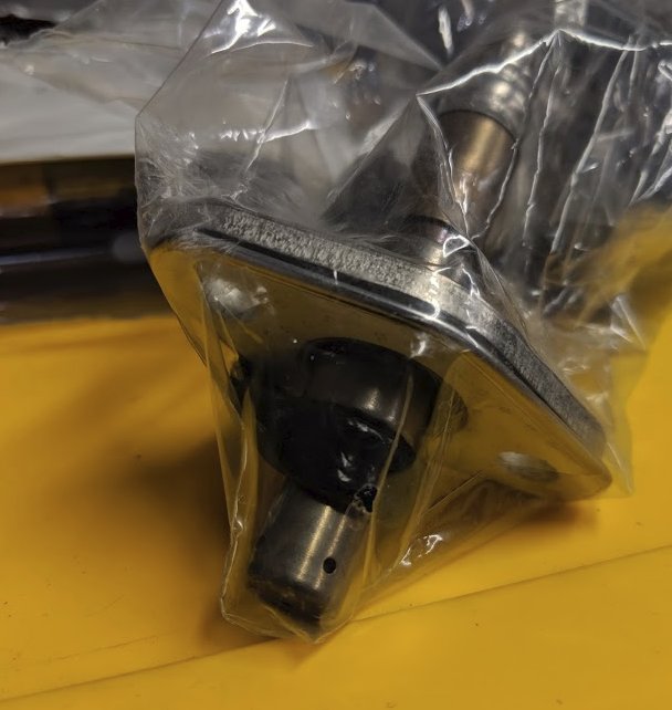

    How is that the opposite? I said counterfeits are just a regular o2 screwed into a flange is why they have the hex. Regular o2 sensors are screw in.

    Counterfeits have the hex, genuine don't. So how I said means the counterfeits don't have the hex?

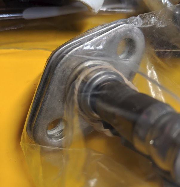

    Genuine Denso & genuine OEM don't have the hex. That's why I stated the prices asked if you had the hex, & posted that pic to begin with.

    :lalala: the densos' I ordered from the zon are legit...

    Yeah those look right. You can get Denso a bit cheaper online over Vatozone but maybe you had a reason to use AZone, important thing is looks like the right ones

    BTW, the generic ones that are just a regular o2 screwed into a flange work. They may not last as long if they do work. It's just that if you are paying $50 for one that is sold as A Denso or OEM you are getting f'd on the price.
    Denso always cost me about $100. Conterfeits are like $40-$50. Generics are like $20-$30.
