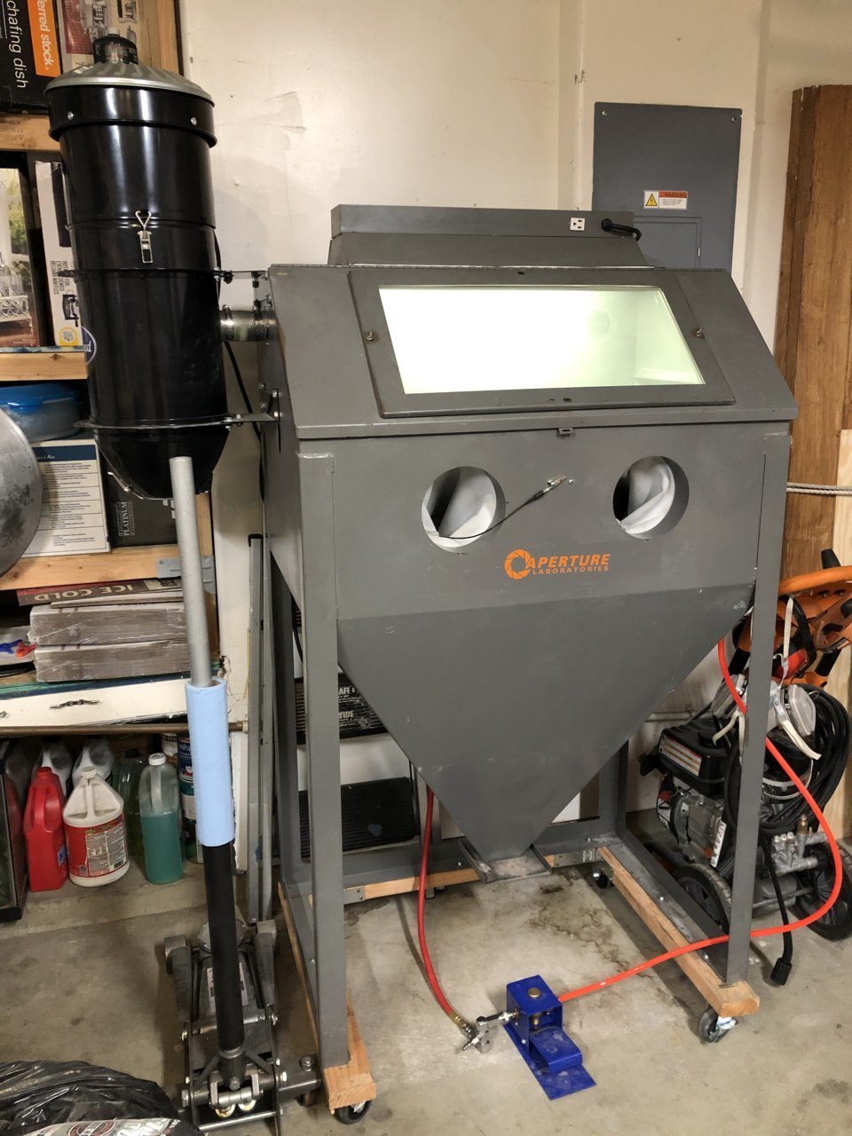

    Here's mine, it's a 90's Econoline commercial unit - it's from a glass etching shop. It used to have a direct pressure pot, but it needed 25 SCFM which I have nowhere near the capacity off. I cut the pressure pot off, and went to siphon. Been working fine since. Here's an old picture, I bought an aggregate vibrator for a grain silo to sort of atomize or aerate the media so it flows better that mounts to the bottom of the chute.
    Nice dust collector on the side too, bought it from Eastwood.
    If you want the pressure pot, it's yours. It's a lot better than recycling media.

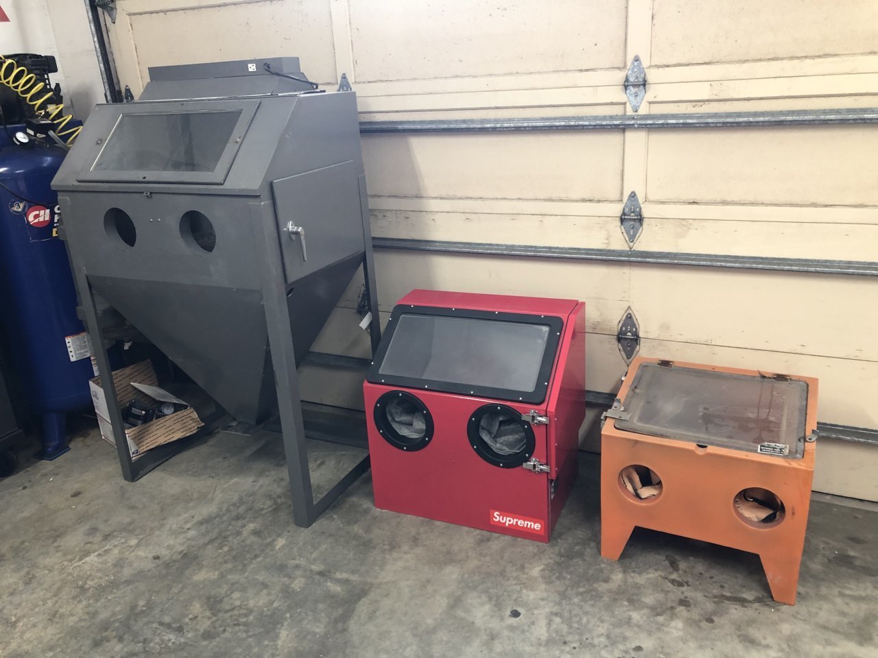

    Just the one below on a table and a portable one from HF. I hang a bunch of tarps around me and on the ground for large stuff with the portable one. I've seen a guy on YouTube mod the red one out and I might look into that soon.

    I started with one of those tiny HF cabinets from the early 2000's when they still made em out of plastic.
    Here's the evolution of my cabinets:
