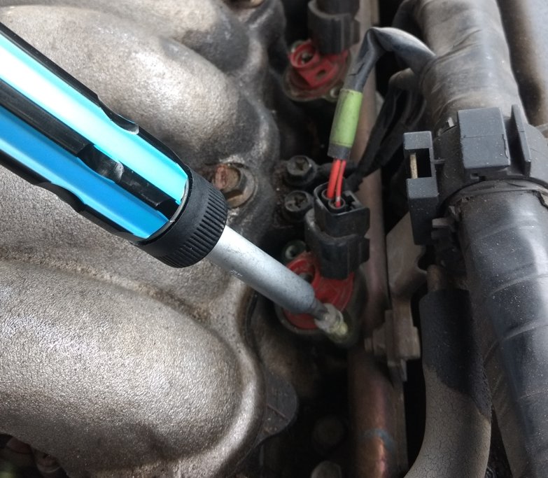

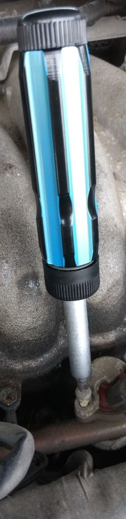

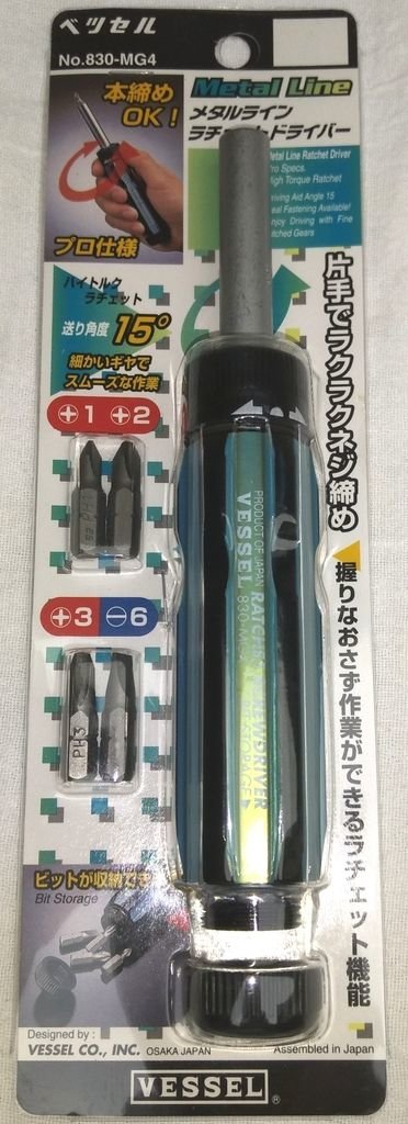

    When I bought it, I took it to the junkyard and used it on some corroded JIS screws that are notoriously hard to remove. It worked and broke them loose.
    I like it because it works with an offset ratcheting set. I have some Hozan JIS drivers that I don't like.
    Since I can't read Japanese. No idea what it says. If it's not JIS, that's news to me. I'm been using it like it was for a few years.

    Ugh feed injectors, I'm gonna guess those unholy bastards were on a VG33, maybe a VQ30

    there are some translations on the package
    it is somewhat coherent lol

    I think all side feeds from the late 80s and 90s use those damn screws.

    The design is just unnecessarily over engineered. They use the soft aluminum hold downs with high grade cadmium coated fasteners that have lock washers that bite into that alum and hold forever. Even uncorroded they're a bitch. It could have easily been a twist lock design and been cheaper and easier while being just as secure.
