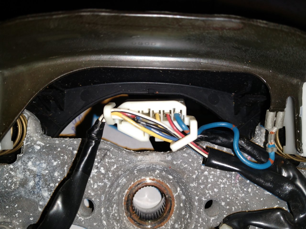

    Hmm this pic of a taco CC harness shows the red and white wires going straight to the plug.FE7C15A9-BC78-4775-8C2D-2FD7F87573D1.jpg
    The IS300 has the white/black wire going to the down button on the left side and a yellow wire in its place on the plug coming from the buttons on the right. Something is fishy here. Why is the CC wired into the buttons?

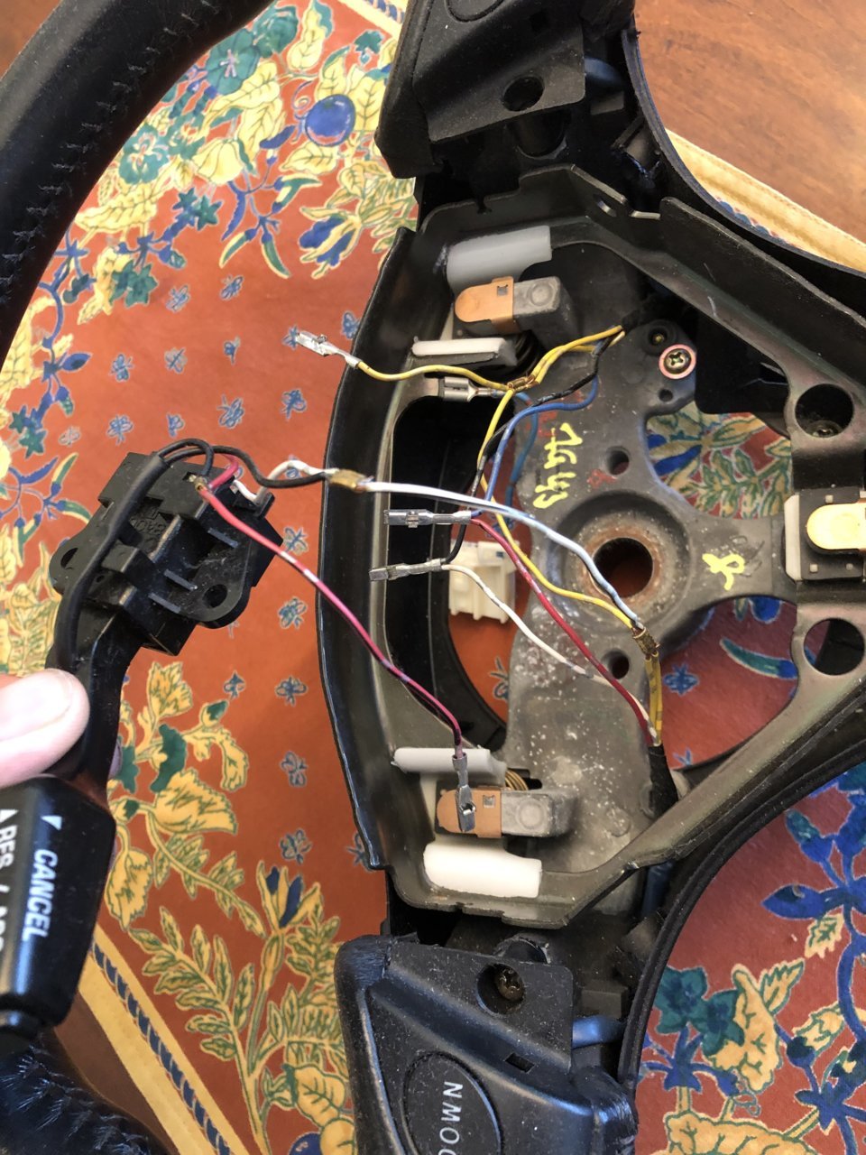

    @Blue92
    My steering wheel wiring is all apart, you can see how it’s wired. The white wire is common ground for all the buttons.

    2018 Sport
    So I should be fine to de solder the buttons and not re solder them?

    I’d just leave them alone honestly. They’re not connected to anything at the Tacoma clockspring.

    Ah I see, I couldnt see those hidden splices.

    I was gonna pop them out to paint them.

    I could do that, but it would be way easier off the wheel. I have a soldering iron so :notsure:

    Yeah wouldn’t hurt to cut the wires. Just make sure the grounds are still grounded because your horn or cruise control won’t work with a cut common ground.

    Im gonna go out on a limb here and say those splices are still good so I should be fine just to leave the switches unhooked.

    Give it a shot. Just as long as your ground is intact you’re good.
