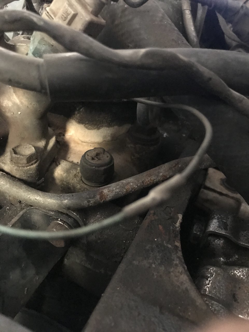

    Its missing the bvsv. Someone by passed that with just a hose because the top of the bvsv is gone

    Oh its not even there? Yeah okay, that can affect things

    That valve will have to be there for sure, unless they have the vacuum hoses routed in a way to do a delete? Can you even do a delete of that thing?

    I just read ip on it. Its design to not allow gas into the throttle body till the engine is at temp. If you by pass it it will allow gas all the time
