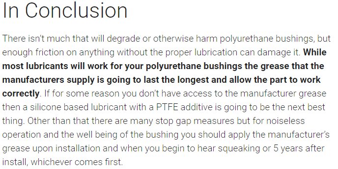

    the best grease to use for poly is the grease the poly bushing manufacturer sells (their brand).
    just any old grease isn't going to cut it and depending on the bushing, may call for a specific type. One of the best articles I've come across re: poly bushing grease
    https://www.suspension.com/blog/the-best-grease-for-polyurethane-bushings/

    yeah I think I remember reading that article before, says that lithium works but silicone works even better basically
