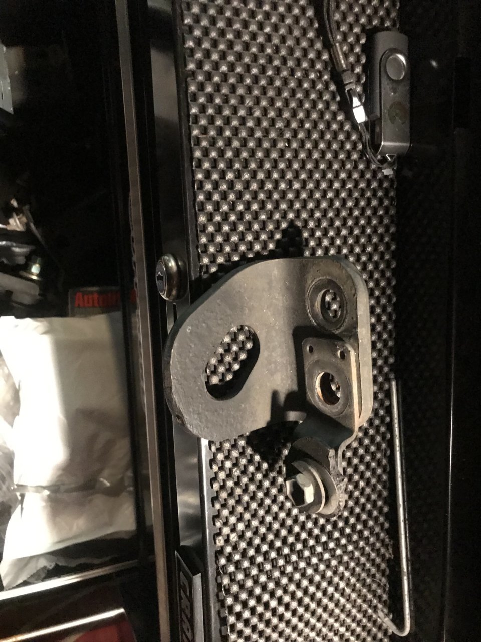

    one tow hook is $9 and the other is $22 :confused:
    but it looks like there are 2 parts to this item
    looks like #12 ... not sure what #13 is?

    Number 13 is a piece of thin type strap metal formed to that shape and bolted with the hook to act as a security for keeping the rope loop or winch hook or whatever up against that toe hook, keep it from falling out of position. The other side that has the oval hole cutout it looks like, actual vehicle not on diagram, is a tie down point for transporting them on the trailers. Not sure if you can add a second hook or not. Not sure of there are existing captive nuts to work with or what. Oh and the bolts holding the hook likely have like 90 ft/lbs of pressure so the bolts are on there pretty damn tight. If you're using a ratchet, if recommend a fixed breaker bar for the socket instead of ratchet, use a piece of pipe or similar to slide over the ratchet handle to give you an extended ratchet handle and really allow you to get some leverage on to the bolt. I'm sure there are videos on the youtubes of something similar if you need more of a visual

    Yeah, same thing. That's normal. Normal vehicles only have the eyelets, but the Tacoma has that hook too.

    11 is a loop like on 5 lugs 13 is a hook like on 6lugs

    5lugs have 2 point and they arnt hooks like 6lugs so thats what i was thinking it is

    5lugs have 2 of these

    6lugs only come with 1

    it looks very similar on the driver side, just missing the hook, it has bolts in it already
