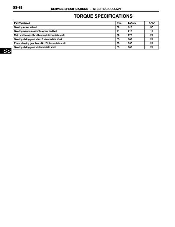

    This thing says 37ft lbs for a 2nd gen so I guess Ill run with that.FSM_Torque_Specs_-_Steering_Column.jpg

    It’s all the same nut. My little impact with just a blip does like 35-40 ft lbs. so sounds right
