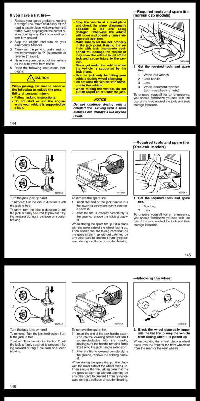

    @cruiserguy, how the heck do i take the spare tire out?
    i found the tool kit under the back jump seat and was trying to piece them together but nothing fit into the hole between bumper and tailgate? i thought that is where you stick it into and turn and twist and it comes down to the ground?

    I'm not positive if they are all the same between the body styles of first gen, lemme check on it and I'll get back. Or if someone else knows in meantime as well. But the rods connect and a hook or t end or similar slides through that opening in bumper all the way to this little crank. Do you have similar?

    Put the hook side in the turn part. Then slide the rod through the hole.

    Does this show anything that could help?

    yes, that is exactly what i was doing
    i just could not find the hole! i had the 2 pieces screwed together but would not fit into anything

    Just slide half through the hole then connect it that way

    i thought that is what i was doing
    can you tell i have never had to remove this tire :p
