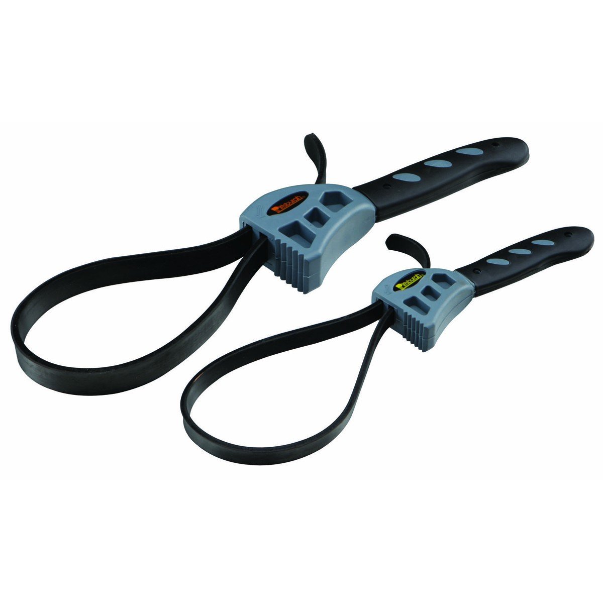

    No way to effectively two hand a 3rz filter. A socket or claw type wrench on about 10" of extensions and a ratchet seems to work best. Or a strap wrench if you crawl under from behind the tire and go up by the cats. Then embrace the mess lol.

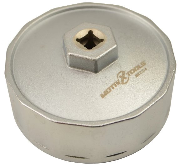

    Do you guys use one of these filter tools? I've got one that requires this to get into tight location to free the filter. That one only works with a specific size OEM filter.

    Yes but there isnt a diff in the way of that one.
