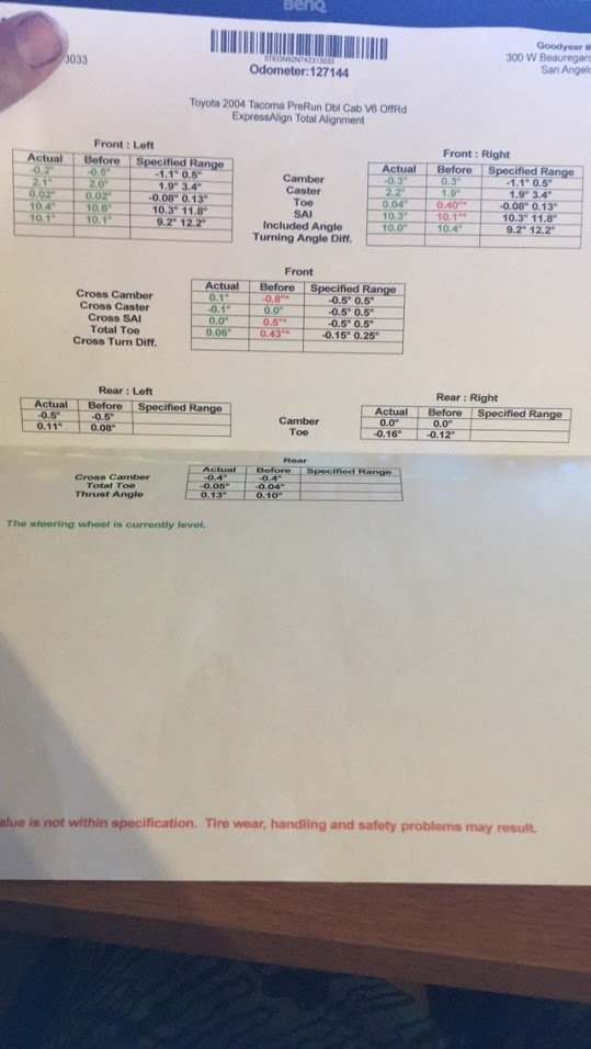

    Goodyear was the only shop in town that I could find to align my truck before my trip. The steering wheel is now an inch to the right and I've taken it back twice now to try and get them to fix it... this is going to be fun.

    They give you a printout with alignment numbers?

    has the rack ever been replaced? it's possible for it to be aligned and still have the steering wheel off center if the rack wasn't centered when it was installed

    I unbolted it for an energy suspension bushing install but didn't unbolt from the intermediate shaft. Can't imagine it's off since all 3 bolts lined back up perfect.

    This is it the second time I took it back. The first time I got it back it was still out of alignment and I turned right back around.

    Didn't specify anything. This is the first time I've ever had a problem with a shop doing a standard alignment job.
