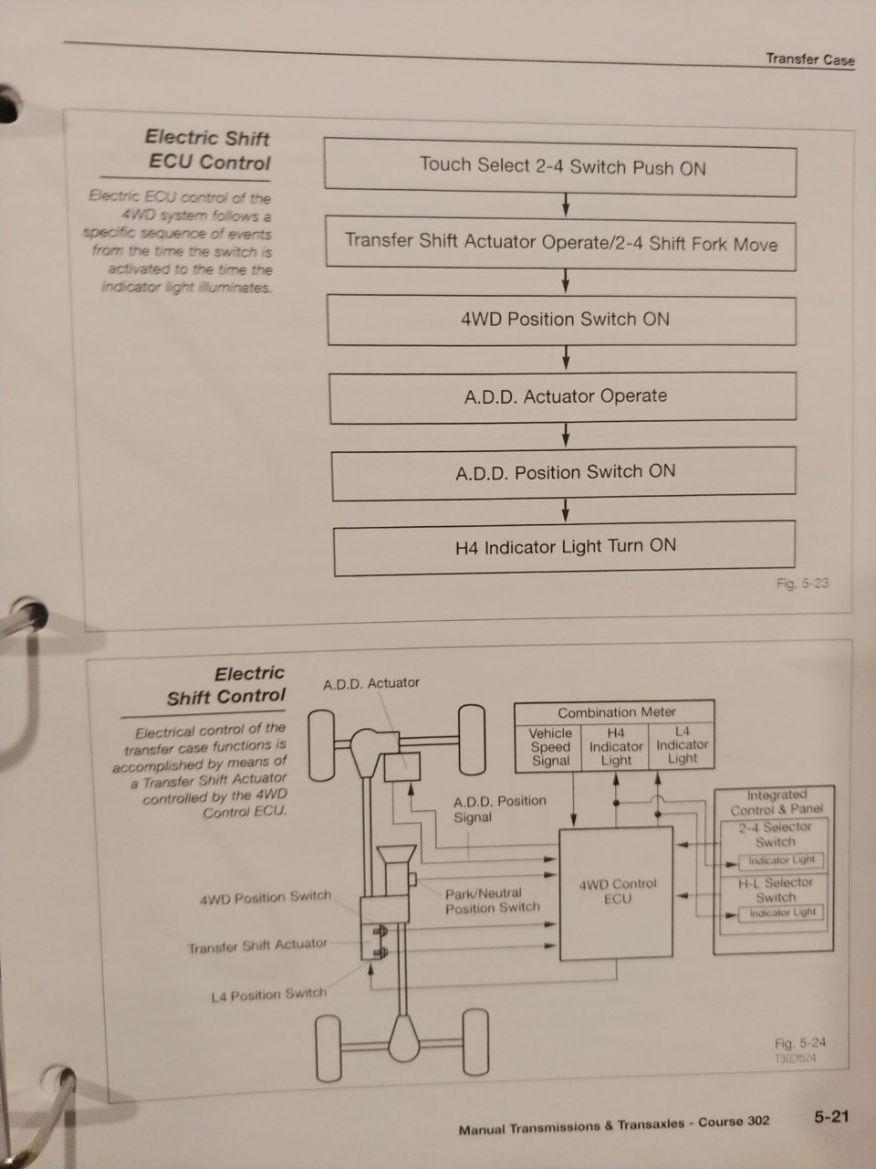

    diff actuator works in all positons? diff moves by hand? transfercase moves in all functions?... could be something with the 4WD computer, a sensor or the wiring

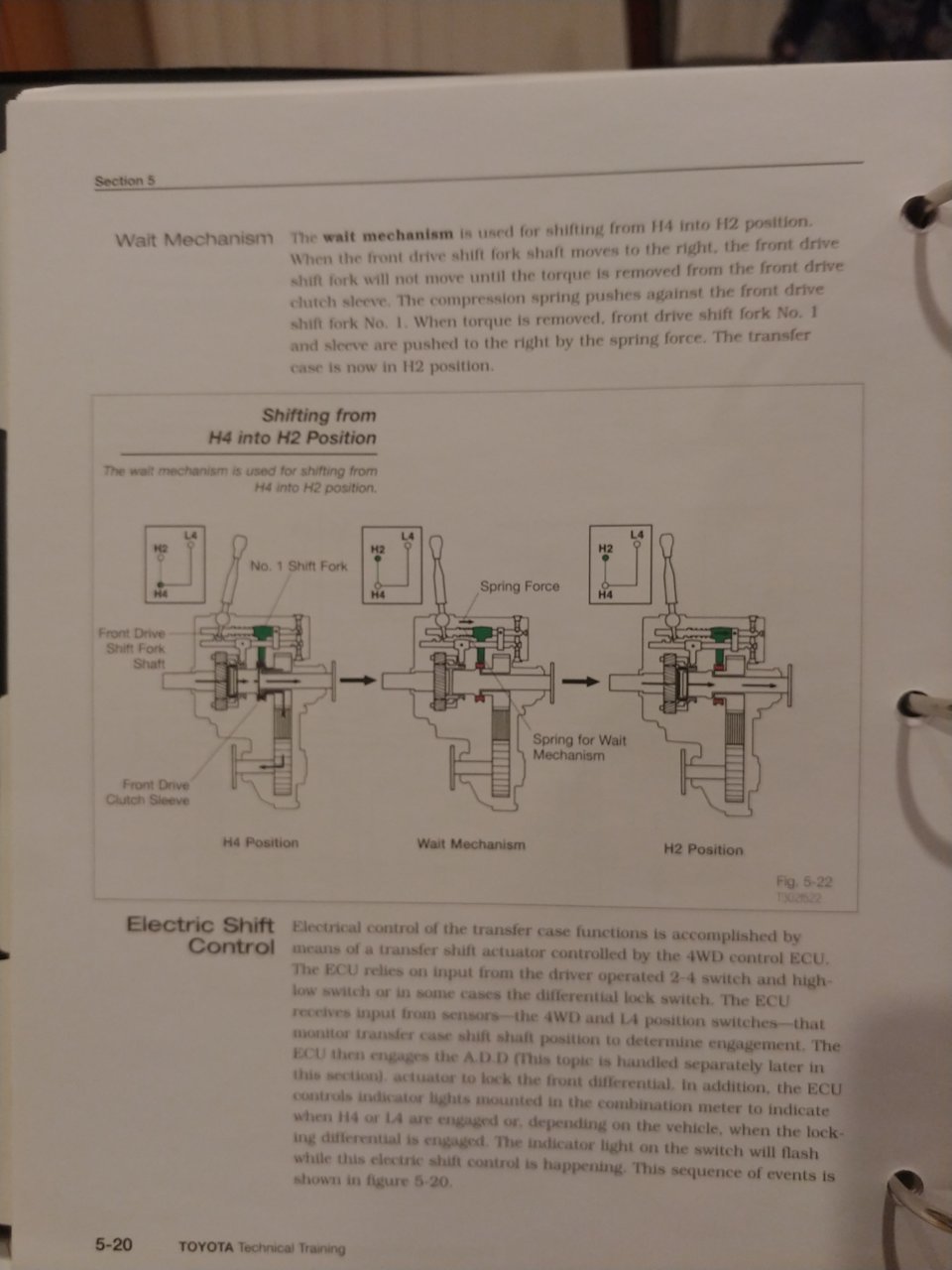

    The add actuator is pretty important, if the the other actuators all work but the add one doesn't you'll still get a failed input

    @Running Man You need my book to understand the workflow of the 4WD comp haha

    the document i sent is the EWD for his truck. it has the description (in words) of how the current flows when operations are asked of it.

    You need to check and see if you're getting the signal from the diff actuator limit switch that it has finished engaging, the 4wd comp will not change the tcase until it recieves that signal
