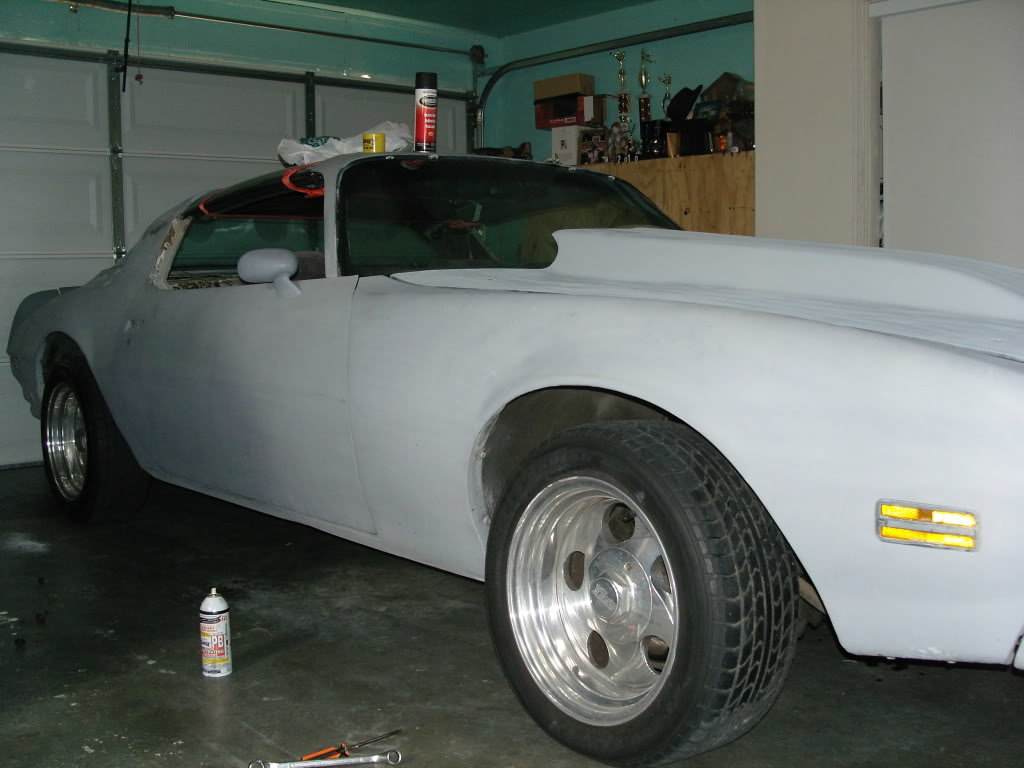

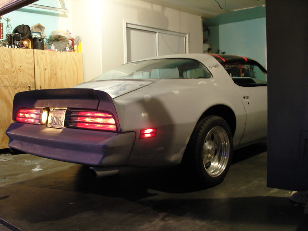

    I saw one at a muscle car get together not to long ago... Damn fine job the guy did at restoring it. Truth be told, when I was a dumb ass kid in HS all I really wanted was a 67 or 68 Camaro SS. Black of course. Couldn't find one so ended up settling on the firebird. Never did like that pointed nose though.
    wanted this -
    ended up with this -
    CS_AR and Kwikvette[QUOTED] like this.
