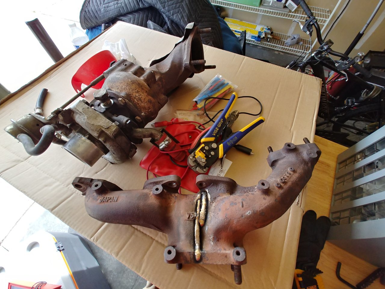

    Got my turbo manifold's gooch TIGd up today.

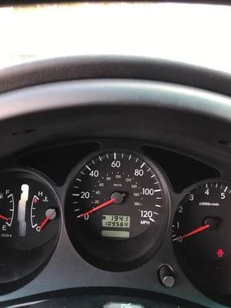

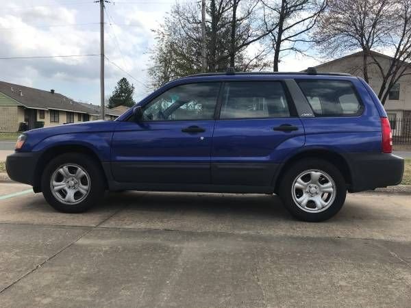

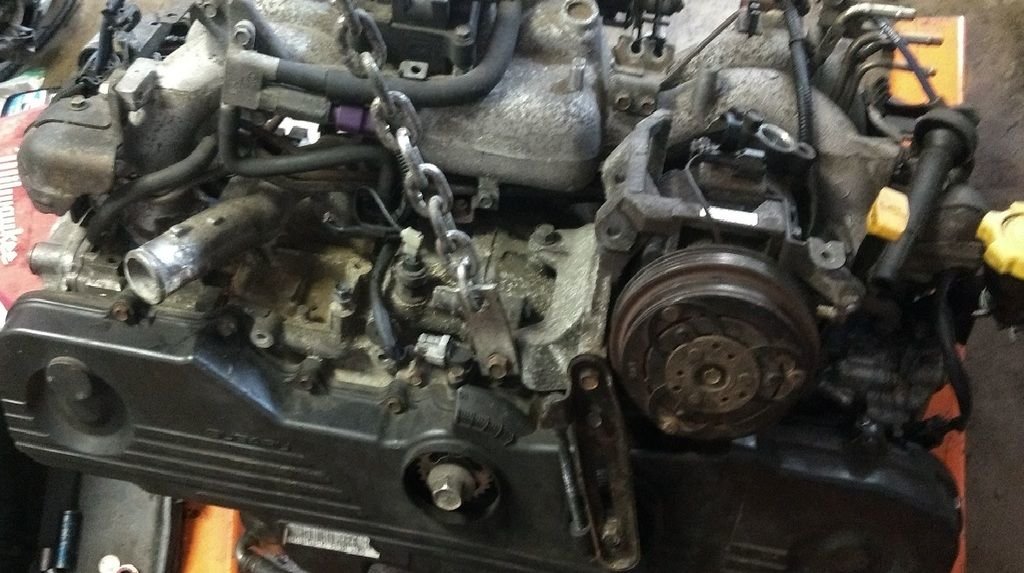

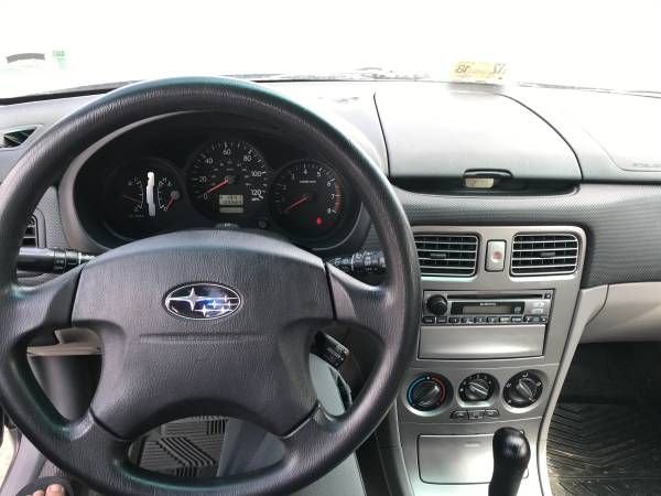

    Built one last year with 110,000 miles. Bought it knowing the head gasket was blown. It needed all things a Subaru will need at that mileage. Pulled the engine and did the full head job and all gaskets, seals, and hoses.
    It was an interesting build and we got to have the Subaru experience. Put in all of the special Subaru coolant sauce. With an FJ25, FelPro gaskets are your friend.
    Not too much activity at the Forester club. But lots of activity good ideas on the Outback club with a bunch of Forester people in there as well. Decided to move on and sold it for roughly a $400 loss after finishing the build. This was the first time that we have built a car and decided not to keep it.

    Well luckily I didn't have to weld this myself, have friends at a local Fab shop that love any excuse to bust out the high frequency TIG. But cast iron welds okay, ideally you preheat it so you aren't focusing heat and you use a filler with lots of nickle, it bonds well and is fairly ductile. And let it cool slowly and naturally, preferably by lowering the temp in an oven. If I didn't have friends with better equipment for the job, I'd have ground the cracks (they were ground for TIG too) and used a stick welder with a high nickle rod and gone to town, seen plenty of stick welded manifolds but that focuses heat even worse.

    He ran it fast and hot, it's not pretty, but it's kinda what's necessary to get a solid root on cast
