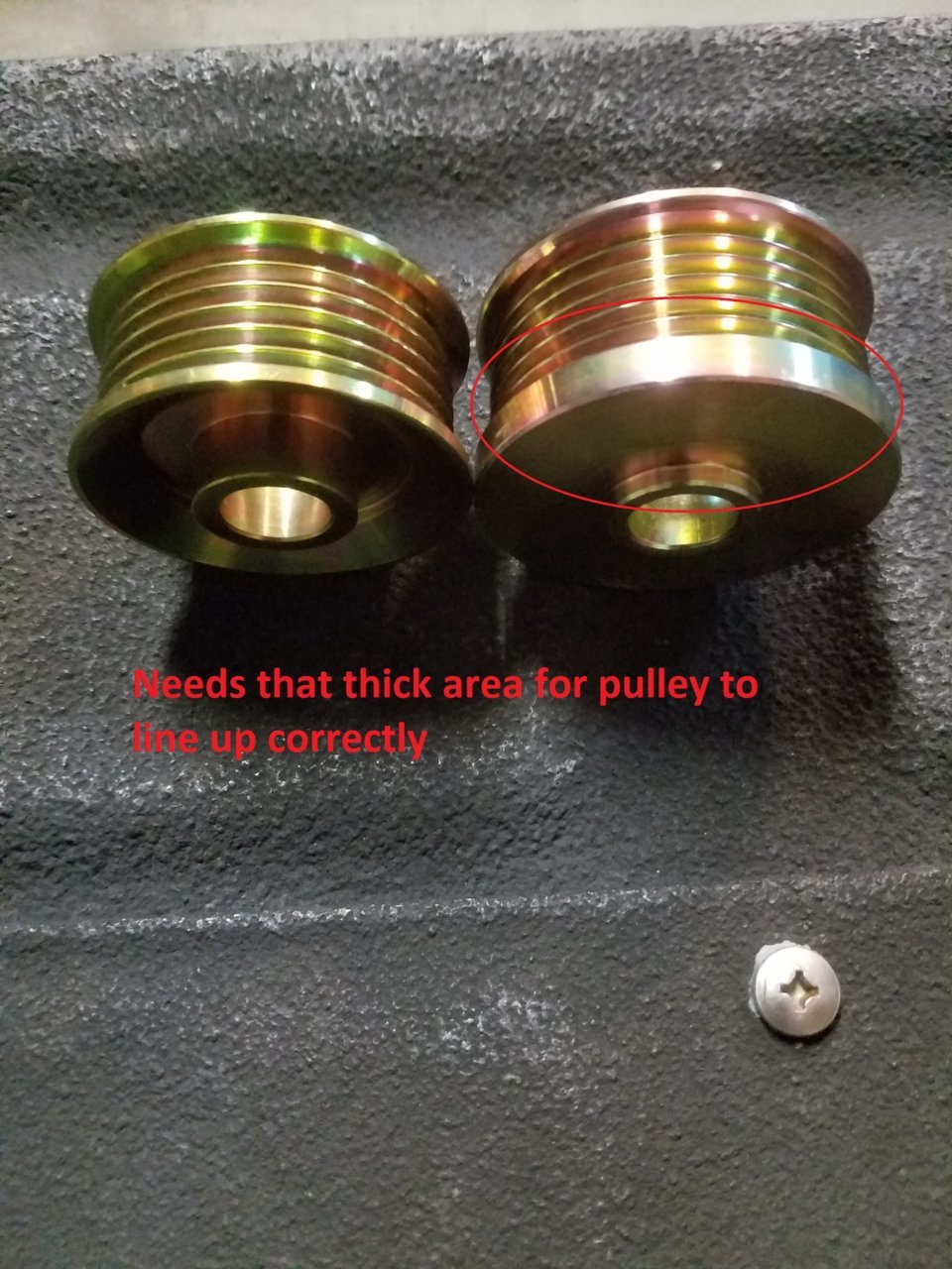

    1/4 inch spacer I picked up from Ace Hardware.

    With a 1/4 spacer and the bottom adjusting bar has to be pushed down a little on engine.

    9/16 I.D.

    tHE oRIELY'S alternator may have the right pulley. let me edit a pic and i'll show you what to look for.20180418_233046.jpg

    That will work. Just make sure it has the thicker pulley.
