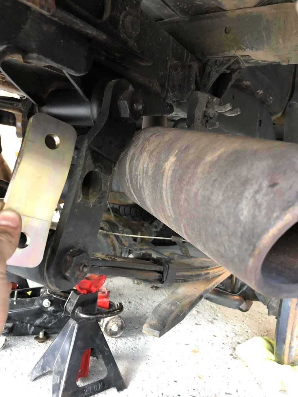

    Are these supposed to replace this

    Yeah but you'll be replacing those lift shackles you have on now. What your holding is a stock length shackle. But if you're putting in new leaf springs for lift you'll be okay

    Also @TheMTBtacoGuy it looks like that shackle is right up against your tail pipe...? Has it always been like that?

    :sawzall: That aint gonna work anymore.

    The pickups had their tailpipe like that. Impossible on a Taco with stock shackles for obvious reasons.
    I plan on getting mine run between the shackle and the spare then exiting out under the corner of the bed at an angle like his. Tucked up but not chopped is what Im going for.

    There is a gap so should I just leave the old Shackle on will it make it taller it looks a little bit better

    Say bye bye to that exhaust tip

    I can’t get this bolt off I already took the nut on the other side off

    Its probably seized to the sleeve in the bushing. Angle grinder or sawzall time

    Ohhh youre in for a fun time. A carbide sawzall blade will fit right in between the leaf spring and the hanger so get snipping. :sawzall:
