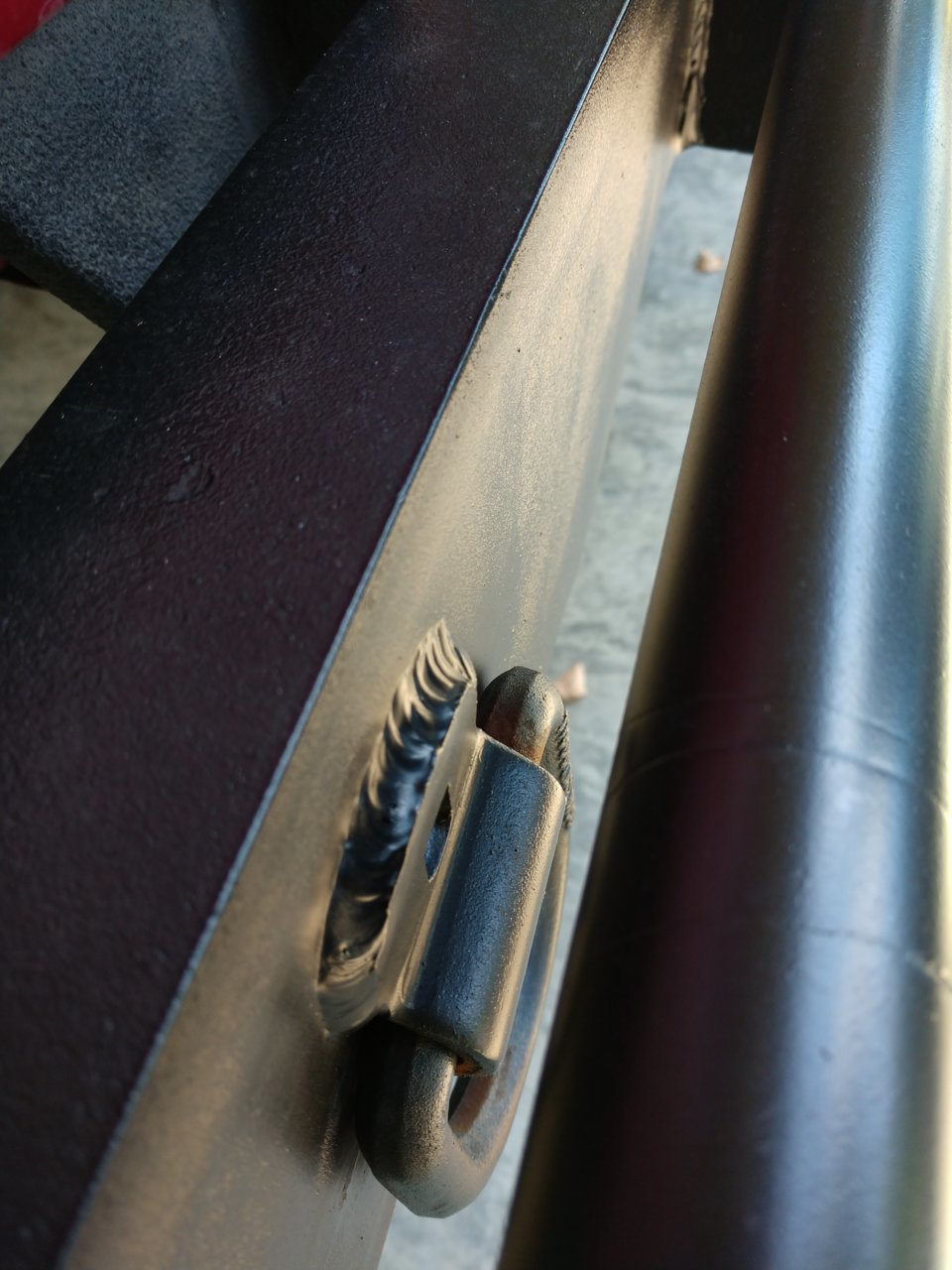

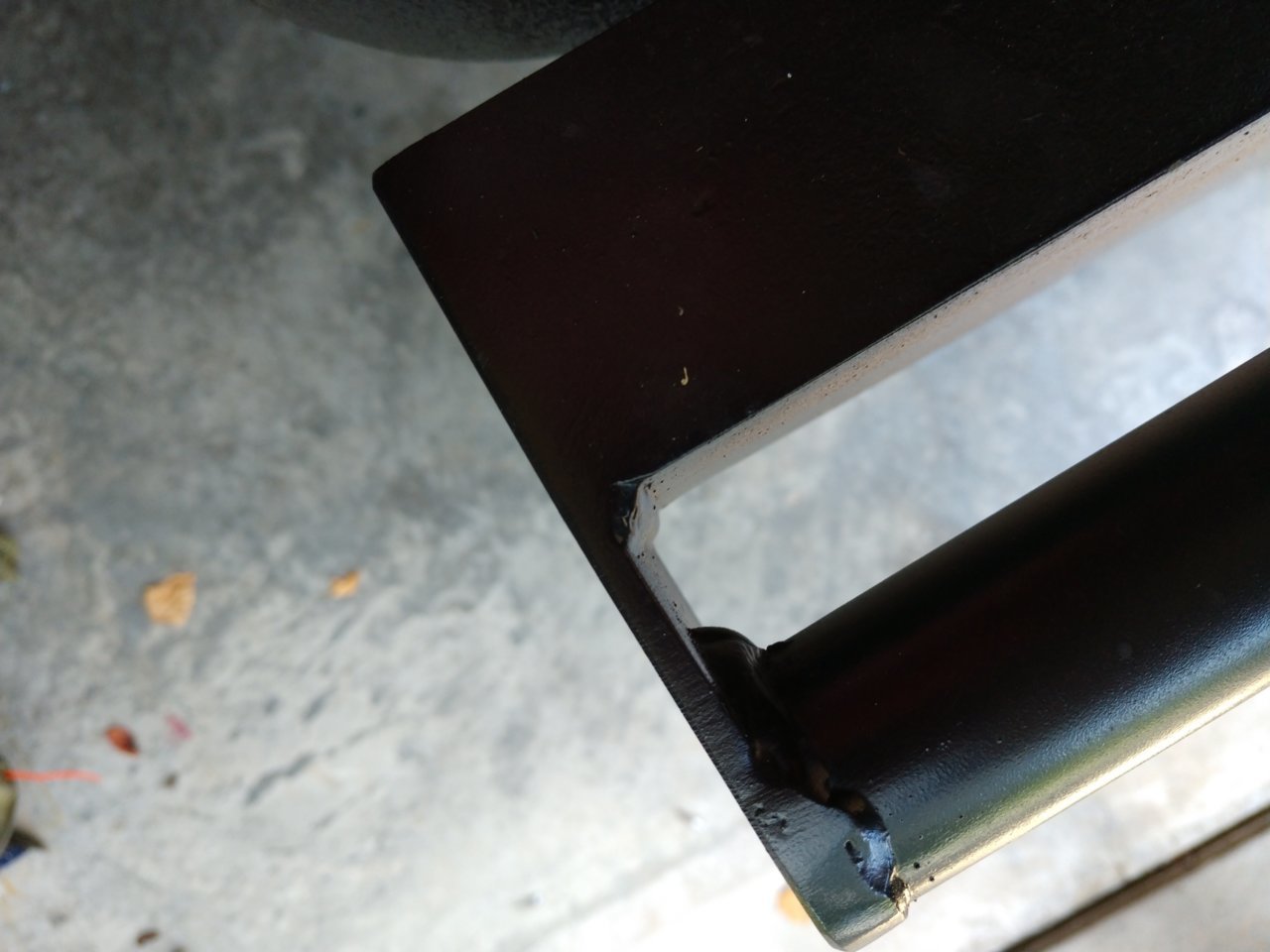

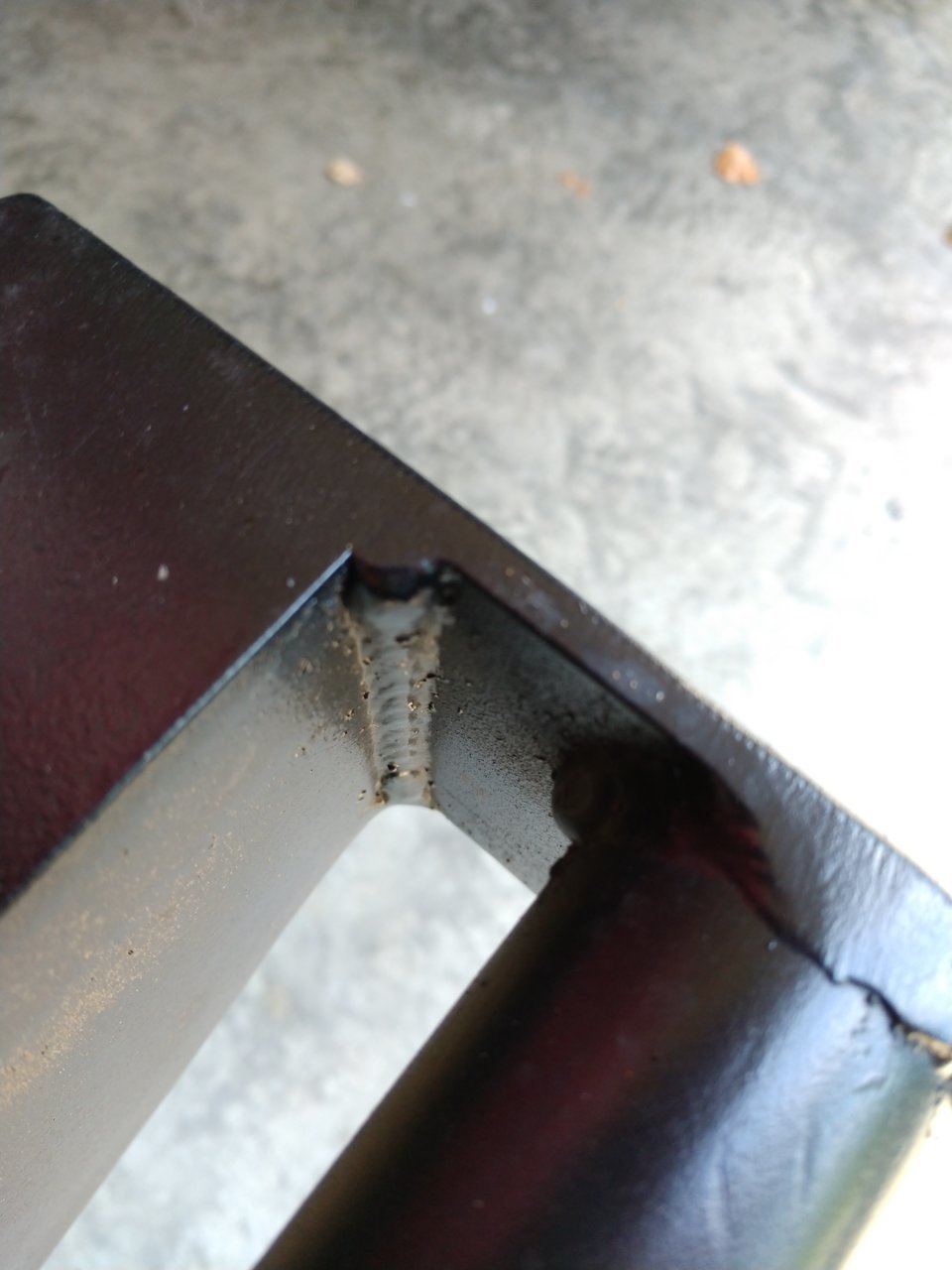

    Heres some welds on my bumper. 1/4" plate fillet welds. Nice and flat with a slight high point at the begining and end.IMG_20190901_175019476.jpg IMG_20190901_175047653.jpg
    And the shackle I tig welded on. This weld is actually concave, as I was welding way hotter than needed. IMG_20190901_175033739.jpg

    Why not TIG the whole thing?

    Time. I did one shackle and cut the pieces at home then burned the rest together on 2 30 minute lunch breaks at work. I tig welded some sliders once. Took forever, was burning 7018 rods towards the end of it.
