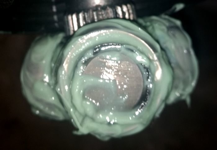

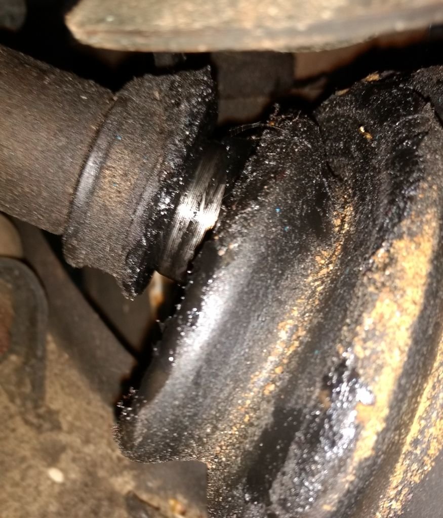

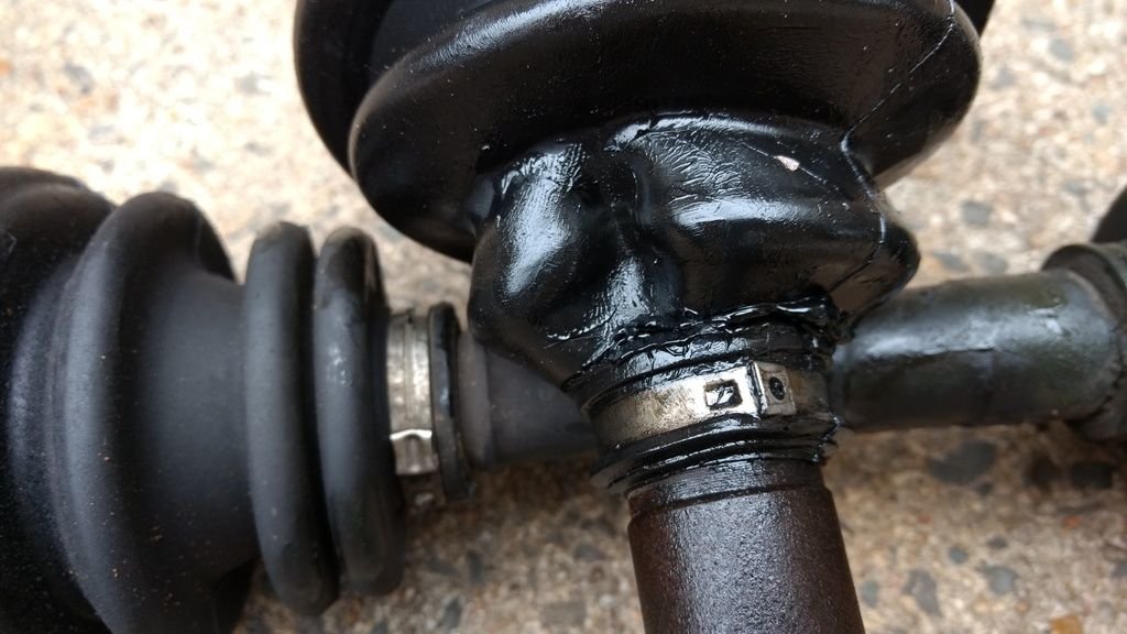

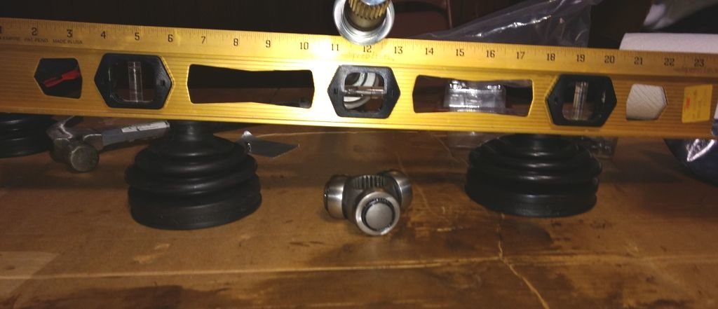

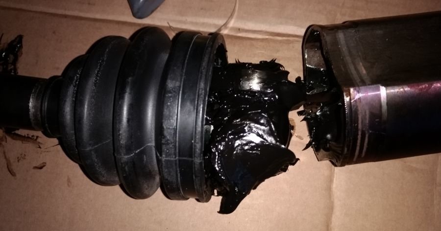

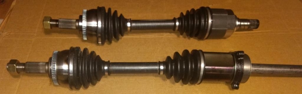

    Ahh ok.. I've rebooted with OEM replacement boots when aftermarket CV joint boots failed. I found a brand of axle with hardware that would hold up on a lowered car except the boots only lasted 3 years. So I switched to the better made OEM boot and used a completely type of grease. I'm fours years into a test that's holding up without issue. The CV axle cost $77, the OEM boot was $30, and the grease was $10. So for $117 wound up with an aftermarket CV axle that is lasting longer because it uses an OEM boot.
    A new OEM CV axle is almost $500 for that car.
    The OEM boots are thick and usually last 15+ on regular cars. I don't know the thickness of Toyota boot rubber.
    I'm seeing some of the higher priced aftermarket boots move to Dupont Hytrel boots that are thinner but are supposed to last longer than regular rubber.
    Aftermarket boots splitting all to hell after 3 years.
    The new OEM boots on the left are much thicker than the aftermarket boots that split.
    These are new aftermarket axles with OEM outer boots.
    Used this type of grease from Omnilubricants.
    The old grease didn't cover well with the additional stress from lowering.
