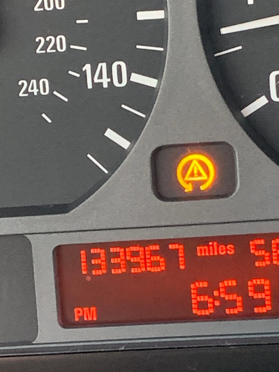

    Any BMW guys know what this means? My buddy and I are stumped.

    Tire rotation

    Traction control off

    Thanks. Buddy said it turned off by itself, how does that system work? I’ve never owned a vehicle with traction control. The Merc has it but it’s a simple button.

    Maybe he pushed the button for too long or one of the wheel speed sensors are dirty/bad

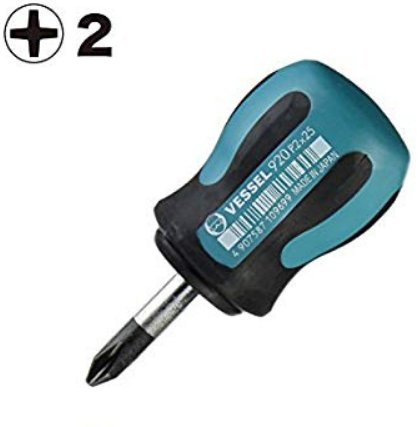

    What's wrong with this picture?
    I pulled off the TPS swap without damaging the little screws, but it was nerve wracking as hell.

    Close.. The hose is not new. I wrapped it up real tight in F4 Silicone tape to keep it air tight and to keep it from springing a leak I'll pick up a new one if I remember on another parts order.
    The problem is with the screwdriver. I should have been using one like this in the picture. I was just damn lucky I didn't strip one of the little JIS screws. I knew going in I had the wrong tool and compensated for it by giving it a lot of extra pressure from behind.
    I've seen some videos where people unknowingly strip those little TPS screws. Then the TB has to be pulled to get past it. Its so easy with the right little driver.

    Ive learned the hard way to use JIS screwdriver head adapters when working on anything truck related regarding screws
