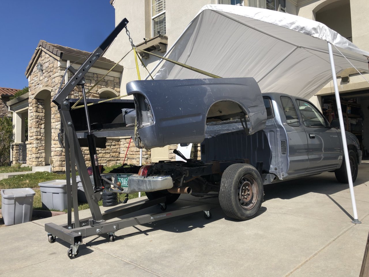

    Pick up an engine hoist from Harbor Freight. Makes the job 100x easier.

    I’ve done it lifting it with two people. Still sucks. You have to lift it high enough to clear the fuel neck.

    Yeah, I’ll give you that. Always nice to have an engine hoist.
    I’m installing an electric hoist from the joists in my ceiling. Going to use 1 5/8” Unistrut on a slider.

    I actually have the HF engine hoist. Does hooking it to the rope hooks work ok?

    Absolutely. Make an ‘X’ with two of them and lift from the center.

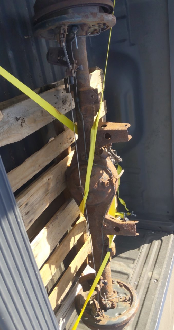

    Found a cheap e locker third, already putting the new truck to work

    How much? I’ve had to put my locker third together piecemeal. I bought he housing separately, the shafts separately, and the third separately.

    '02 and up I take it?

    The locker? Came on 98-04

    No, the entire assembly he posted.
    Just checking to see if I'm right in thinking that the e-brake line runs across the rear end on an '02 and up vs over the housing on a '96-'01.
