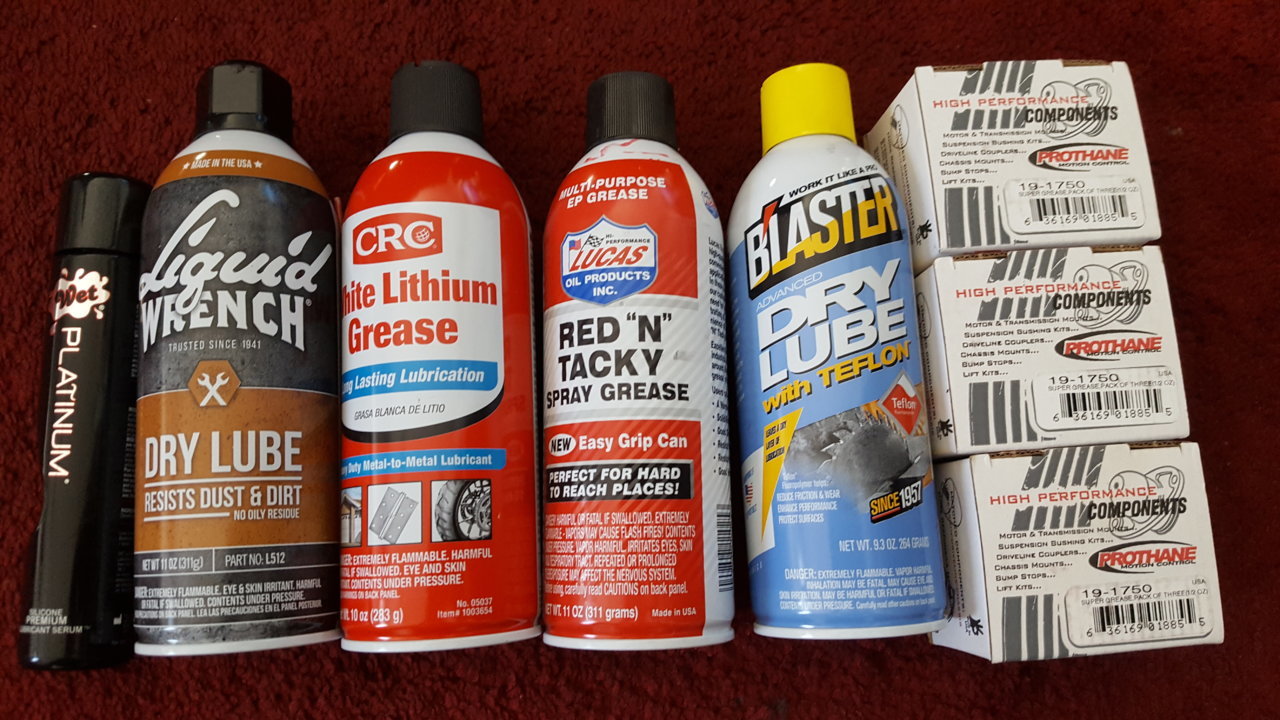

    Enough of the talk on bolts. Going to kick the OCD into high gear and I'll have to replace them o_O

    huh I didn't know Red N Tacky came in a spray can, interesting
    I go through the Dry Lubricant cans every few weeks lol. That stuff works great for just about everything but doesn't last very long.

    Yeah stupid convenient, and it spreads/expands once it's sprayed so you have to be careful not to spray too much.
    It's just a waste of money to have all these extra cans.

    Silicone could cause potential UTI my man. Gotta go water based.
    Side note, that Prothane supergrease (ketchup packets) is super water resistant- more than anything else I've ever used. They'll be the perfect thing to use on your leaf spring bushings or other areas that are semi-exposed to the elements since they resist being washed away by rain and/or carwashing or otherwise "melting" away. Bring a few packets when you come by next week, we'll do your bushings then too.

    Each one of those cans could serve a different purpose. You should se my collection of lube. The Blaster Dry Lube with Teflon is great for Uniballs too BTW (since I saw you talking about UCAs and uniballs). Not sure if the liquid wrench dry stuff is the same but I'm sure it'll work. The white lithium and red n tacky could be mostly interchangeable for around the house stuff. I use white lithium for single use lubrication ( like the needle bearings in my tube notcher)- don't use it for any other type of bearings! Red N Tacky is a great general use grease, but tends to weep in hot applications, just an FYI if it'll be used anywhere visible or where aesthetics are a concern.
