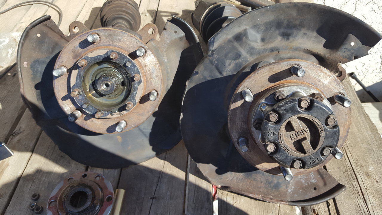

    That one bolt had bottomed out. And you railroaded it because you knew it wasn't cross threaded because other wise how'd it get in so far? But yeah thats how we learned the reason for the longer bolts right? For the LBJs that have the dust cover with that solid spacer in it? At least I thought that's what we learned
  5. Oct 9, 2019 at 11:02 AM
    eon_blue
    Mar 4, 2016
    #180213
    69,810
    Azusa, CA
    yeah that's right, it was that damn washer-type thing that was supposed to be on 2 of them to hold the dust cover in place...wasn't on there so that bolt bottomed out before torque could be reached, and snapped.
    When I take them out now I always put them in the exact same hole they came out of, don't mix them up so I don't forget which one has the dust boot washers and which ones don't
    cruiserguy[QUOTED] likes this.

    I'm just glad you said pretty descriptively what happened and what you did. I don't think anyone ever mentioned about the longer bolts in any threads.
    And what the thread locker can do if reusing the LBJ bolts(I do reuse but no threadlocker) is cause it to show a tight torque reading way prematurely as that crap builds up in the threads and has nowhere to go and it's hard and crusty and fuggerin up the torque reading. So Dan gives pretty good advice above. I didn't know there was a chart to compensate for torque specs on threadlocker

    And the hub assemblies were all pulled out last week; brass punch worked like a charm .

    The inside of the hubs don't need much grease. You just put a light coat of grease on them, basically where the parts slide against each other. Where you need grease is on the end of the CV axle, where it goes in to the hub.
    I used Redline CV2 grease for the light coating of grease inside the hubs, on the end of the CV axle, and also inside the boots of my CVs when I rebuilt (re-booted) them. You just need to use a decent grease that's rated for a heated application. Some of the heat from your discs is going to bleed in to your hubs.
    For the rubber O'ring on the manual hub dial, I used a waterproof o-ring seal grease. I wanted to try and keep water, dust, debris out of there because it will make your hub dials start to get hard to 'lock/unlock." NAPA sells a product called Sil-glyde. That's what I used. But I'm sure there are other similar products out there that would do the same thing.

    Yeah I've read that if you put too much grease, it'll be harder to turn.
    I've got new o rings and gaskets as well. Just read too many different threads from people all over that rebuilt their hubs with different oils/grease. We're both in Cali so I figured I'd use whatever you used.
