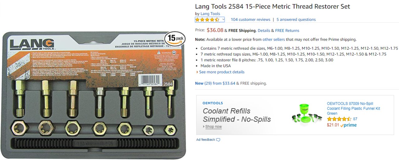

    I ordered this exactly set yesterday. I believe Chaser and Restorer are synonymous. A tap and die is what you don’t want.

    fuck it run the tap

    I’ve done that multiple time, it takes off a lot of material. I re-tapped a water pump bolt hole in that Civic EJ I did a while ago. I could wiggle the bolt after I tapped it. Still held the pump on tight, but it took off a lot of material. It was seized from rust so I had to retap it.
    It was a miracle I got that bolt off to begin with. It was so stretched once I took it off.

    Yeah, it really does. I had to retap the egt probe for the 6.0l and it whistles now because the exhaust leaks when it's under heavy load :bananadead:

    Shit man... I should have told you to order it on Amazon (my bad). Could have saved you a bunch of trips.

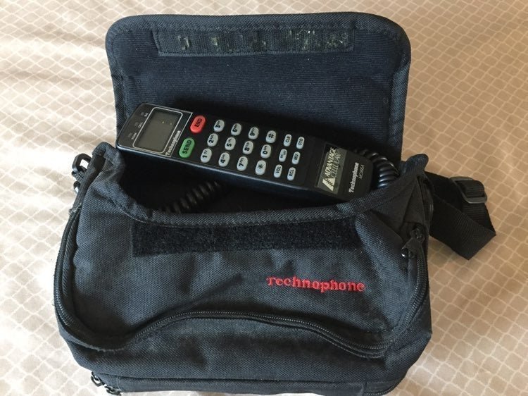

    LOL... My first cell Phone

    There are different thread classes within the same pitch. They differentiate the amount of clearance/tolerance between external/internal threads. Class 3 being the closest tolerance, class 1 being the loosey goosey one. Most chinesium taps are probably class 1 but not labeled. Fun facts.
