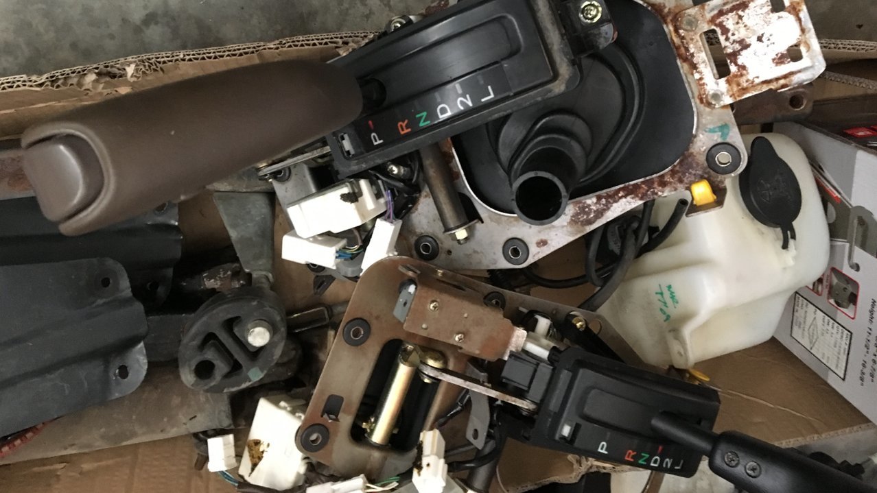

    There's little odds and ends you'd need that I didn't know about at first. Specifically the 4WD Shifter Console (you don't need this, but it makes for a cleaner install), and the A340F transmission mount, among others.
    If you want to swap out the console which I recommend, I would go for a 4Runner one. They come in black and look better than the color matched in my opinion. I sold the 4Runner trim and ADD knob and actually made a profit on it after paying for the console. Plenty of 4WD 4Runners around.

    @Kwikvette OH! I almost forgot. I didn't have this part which kept me dead in the water for a few days. The transmission dipstick and tube. You can't fill the transmission properly unless you have this. I had to order mine new from Toyota for about $150. Make sure the trans you are buying comes with it.

    Crossmember is the same, you only need the mount. I just wrote that because they sold me the entire crossmember.

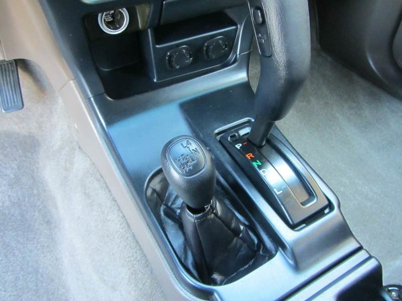

    The shift console, how did that get damaged?

    It's affixed with an o-ring and a bolt.

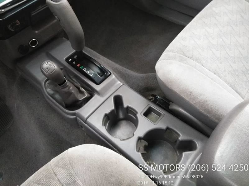

    Black definitely looks sharp, but will clash with the grey cup holders.

    Easier to keep black clean, the gray shifter gets dirty often.
