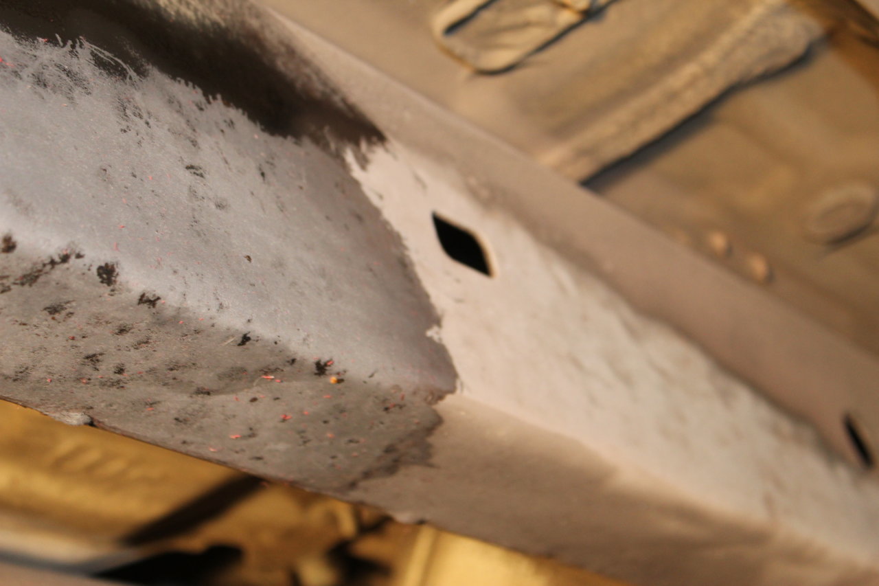

    yes, i did not have time to do it before the weather turned and I have to get on the road the rest of the week with it
    i will have to read the instructions again, i did not see anything about applying to non-painted metal

    It's not that you can't apply it to bare metal, it's that nothing will adhere to it well even after cleaned, maybe, I dunno. Something like that

    i guess i shall see later when i can powerwash it and wipe it again with the acid and see if any comes off on the white rags
    maybe re-blast it? which i have to do in spots anyways
    i have 3 types of media now, glass beads, aluminum oxide and soda!

    it's not 'bare' there is quite a bit of the after blast wiped on it to turn it silvery

    one thing i did read on the instructions is that it can soften any undercoating applied from dealer or other, etc.

    i was 'careful' not to spray FF inside because i still need to clean it somehow (magnet, vacuum, airhose) and do a couple coats of internal frame coating to seal it all up

    IMO it was a mistake to leave it unpainted. You’ll never get it clean enough again to paint it properly in the future.

    i was led to believe it washes off somewhat easy, that is why some apply twice yearly :notsure:

    It may wash off easily but you won't be able to easily paint anything it's been on, I'm guessing. But we're arguing hypotheticals that don't matter. We're at where we're at and need a plan of attack now.

    He could blast it again

    Not with that Fluid Film on it. Grease, and powdercoat will just absorb it.
