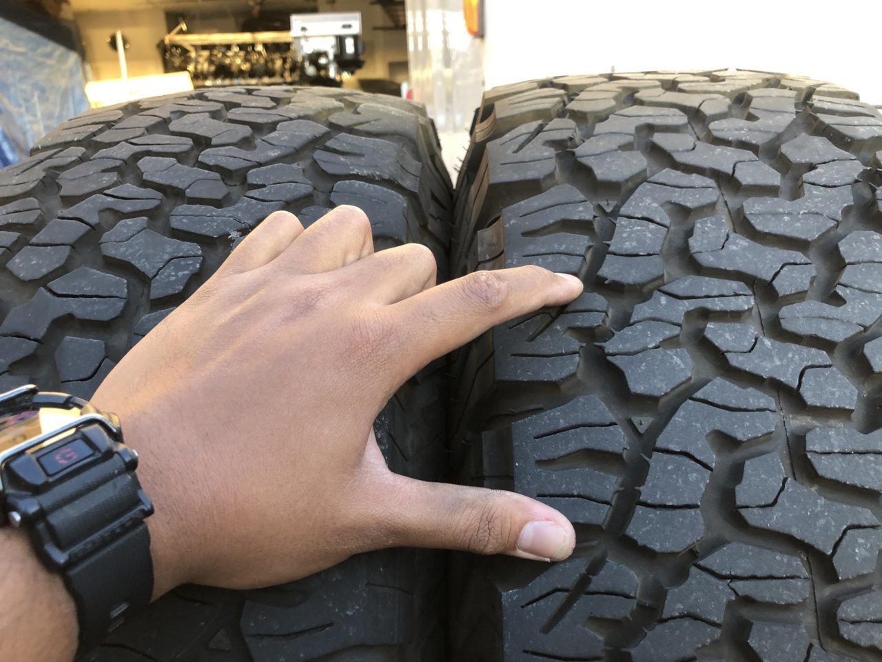

    So my noise was from the tires. They were severely worn. Once I rotated them, the noise went to the rear axle.
    Guess which one is the front tire.

    The left tire. Uneven shoulder wear.

    You got it. I’m going to run these for another year and ditch them for better tires. New wheels too, the TRD OR wheels have lost their appeal to me. The tucked in backspacing outweighs the pros to me.

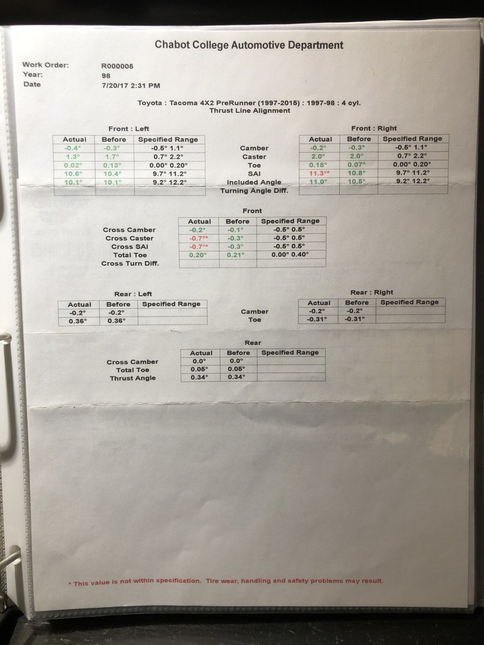

    I found the alignment sheet from my auto tech school. I didn’t adjust anything, but here are the readings from a Hunter laser alignment machine.
