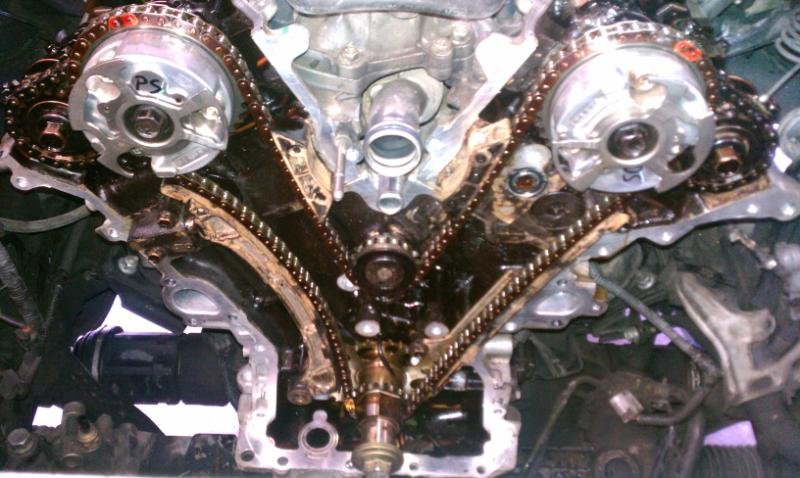

    toyota 4.0 timing chain setup
    [​IMG]center pulley is just an idler and its got a massive bearing
    Ford 3.5 timing chain setup
    damn near identical setup, but with terrible water pump placement. center pulley sits on a much smaller bearing so over time with chain tension it wears and creates shaft play allowing coolant to pass by into the oil, so much play can occur that it'll jump time

    the 4.0 is fine.. to get rid of the water pump in a ford 3.5 you'd need some pretty good custom work going on. its critical to timing chain tension and control
