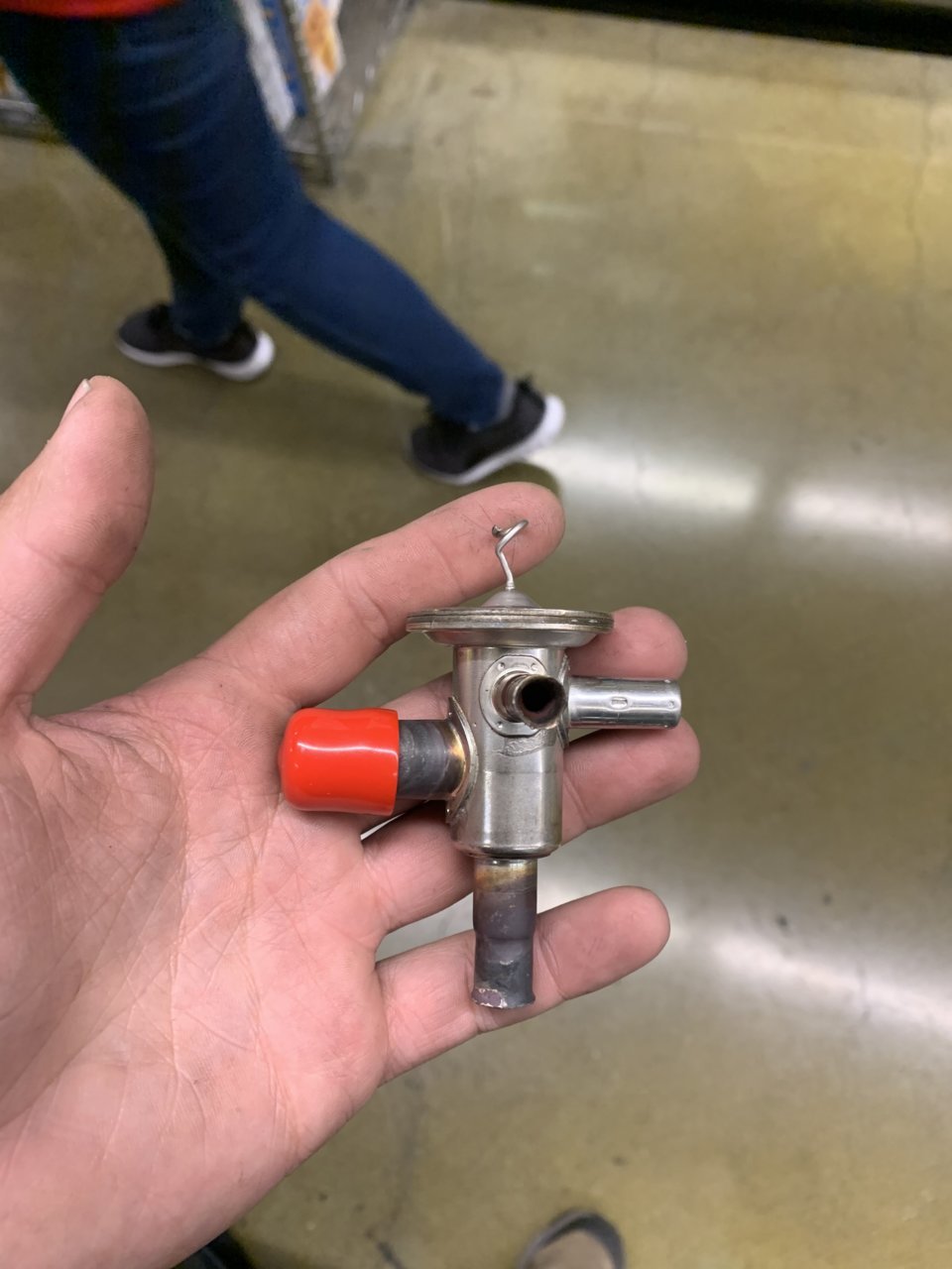

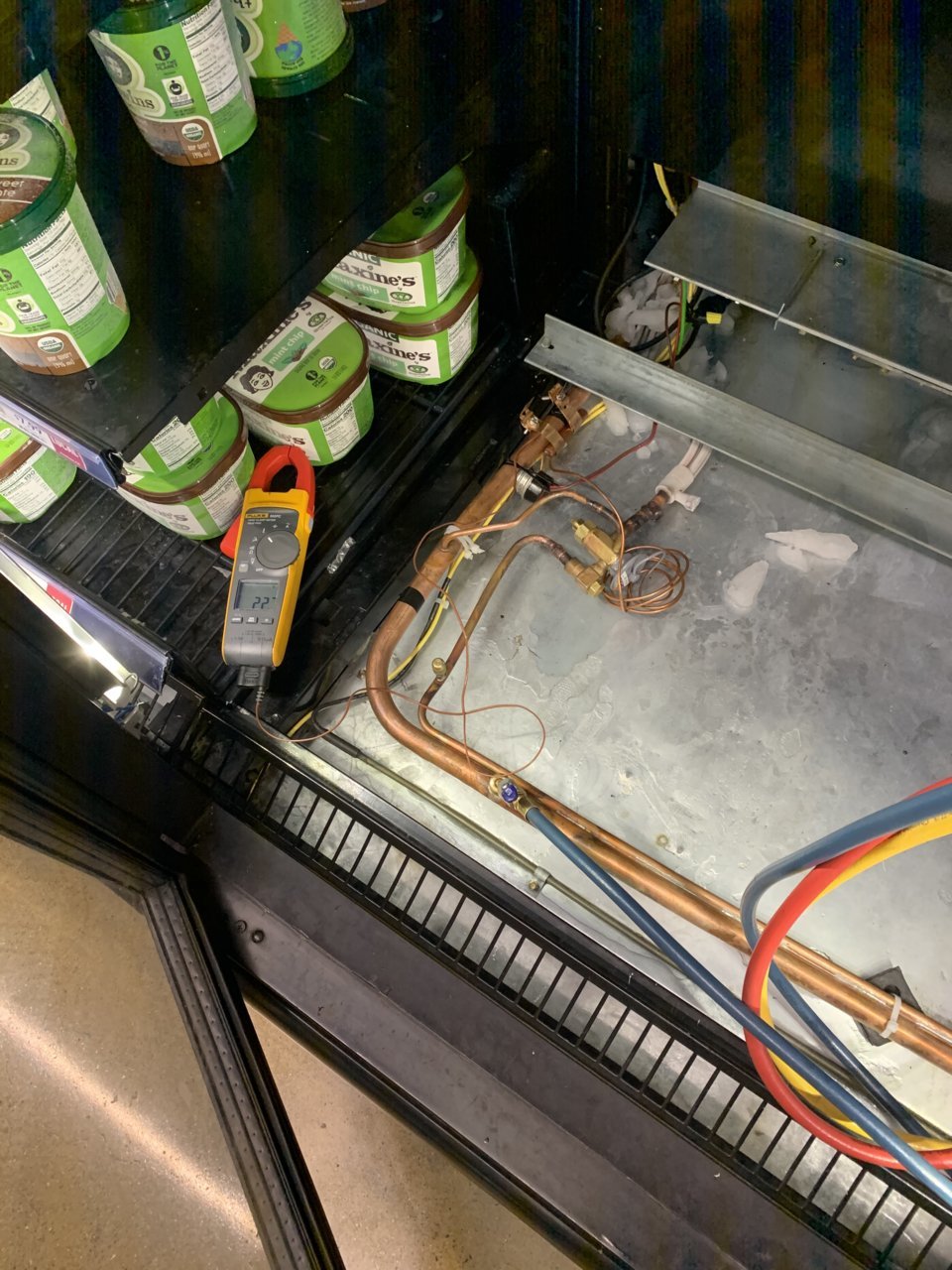

    I mean all i had to do was take off this one. Then put in the new one and show him how tp put it together. But that means pumping down the case and brazing. Which my boss didn’t feel comfortable with the new guy doing on his own.

    What was the issue? And what is that? A valve? A collector?

    Case wasnt cooling. Staying at 7°. Wasnt iced up though amd had good airflow. Found the TXV (thermal expansion valve) wasn’t metering like it should be. And on the one one its not rebuild able. Probably the power head was bad or maybe the screen was clogged. So I throw in a new one thats re build able.

    Power head on the new one just screws on. But yeah i had to sweat in a new txv because the old one took a shit.

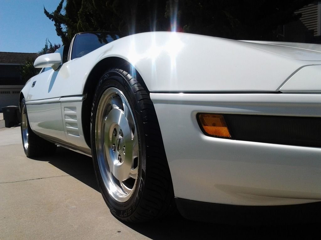

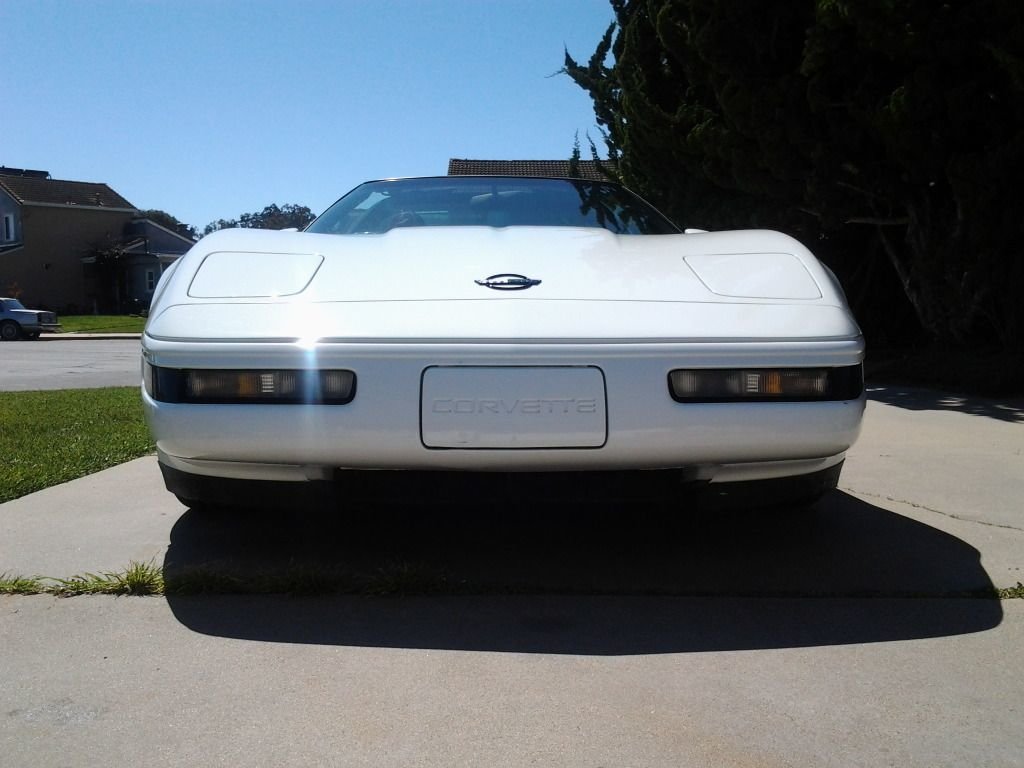

    I've posted a ton of my cars so I won't muck up the thread with that again; I'll limit the pictures to my C4 that I've owned for almost 15 years now. It's far from stock, and not street legal but still retains the original factory paint -
    With that being said, my tried and true method is pretty basic -
    Hand wash with a quality soap, using the dual bucket method, in the shade.
    Dry with a clean chamois; this is especially important as you don't want any residue's spreading all over.
    Clay bar.
    Wax with nufinish; once its all hazy, use a clean microfiber to wipe clean
    After a week, I'd apply another coat of nufinish, and I'd be good for up to 6 months in dry weather.
    04Pre_Runner and GQ7227[QUOTED] like this.
