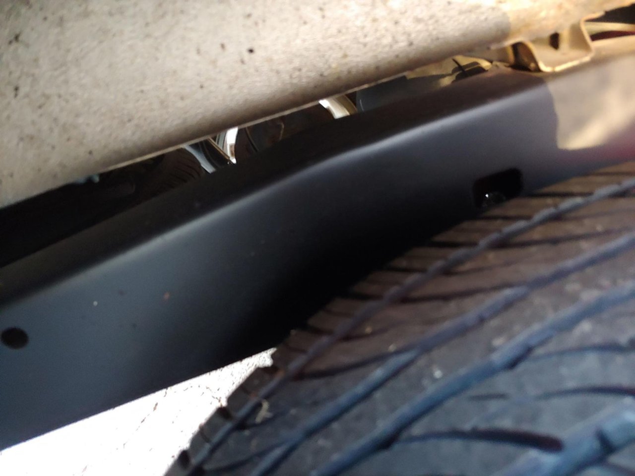

    just stick your fingers around inside before you take that sledge to it

    Type the VIN into here and it will show all the work done by Toyota. If the frame was replaced it will show that it was

    you can also cup it up back in there as well to see what is what
    like you are grabbing a female buttocks :)

    That does look new to me, or a really good paint job

    My question is if toyota did anything at all to the frame wouldnt it be on the carfax ?

    Yes around 2010 there should be a note saying it was checked for corrosion and sprayed, if the PO brought it in. Atleast the Toyota owners site does for mine.

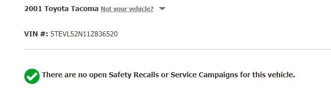

    there is your answer (i think)
    10/1/15
    Provider
    Toyota Direct
    Service Type
    Dealer
    Mileage
    128,055
    Repair Order #
    0837966
    Services
    CUSTOMER STATES WAS ADV THE LEFT AXLE SEAL IS LEAKING, SHOES SA TURATED BY FLUID.. DRUMS NEED TU RNED.. ADV ON PRICING ~|~ ~|~REPLACED THE DRIVER SIDE REAR BEARING /SEAL/ O-RING/ REAR BRA KE SHOES, CASE/RETAINER & RELATE D PARTS., *** OPCODE NOT ON REPORT ***, CUSTOMER STATES BATTERY TESTED -
    Toyota Direct
    Service Type
    Dealer
    Mileage
    116,188
    Repair Order #
    0801197
    Services
    INSPECT DRIVER'S SIDE FLOOR MAT, PERFORM MULTI POINT INSPECTION, CUSTOMER STATES PERFORM SPARE TI
    Toyota Direct
    Service Type
    Dealer
    Mileage
    Repair Order #
    0745029
    Services
    CUSTOMER REQUESTS A 27 POINT MUL, CUSTOMER STATES ORDER FRAME- APP ROVED THROUGH TOYOTA ~|~ ~|~REPLACE FRAME ASSEMBLY. INSPE CTED., *** OPCODE NOT ON REPORT ***, TRAC LOANER VEHICLE
    Toyota Direct
    Service Type
    Dealer
    Mileage
    92,680
    Repair Order #
    0744170
    Services
    SAFETY RECALL C0V REMEDY - CERTAIN 2001 - 2004 MY TACOMA ORIGINALLY SOLD IN AND/
    July - 2o13 frame replaced

    That's definitely a new frame. Can't say how new, but it's definitely aged and weathered quite differently compared to the body sitting on it

    i looked it up already

    I don't think a carfax would have it. Maybe it would, but carfax kinda sucks. Really deceiving. But it should definitely be in the Toyota database if it was done.
