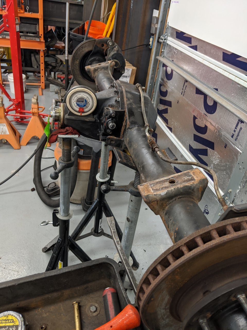

    Rear should be good for 37-40s

    Front will probably not be good for anything bigger than 35s.

    Maybe the Dana 60 on my garage floor will turn into something... I would have to regear the rear again because nobody makes 5.29$ for a 60.
    Closest is 5.38 which might work or might yardsale my t case

    I'd probably get a diamond housing for the front and run the LC 9.5 third

    LC's don't use a 9 and 1/2 front, they use an 8 in front. So you'd have to do some special shit with axles and reverse rotation gears to make that work because even the spline counts are different

    must have been thinking about something else. Can do whatever with a diamond since you probably want custom shafts anyways. Could run a Ford 9" third even.
    My rear is Toyota 8" third and 3/4 ton Dana 44 spindles and hubs
